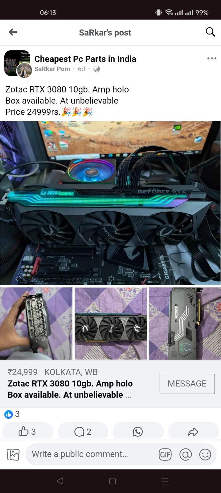

I’ve seen a few fb posts selling 3080 10GB for 25-27k. Is this worth upgrading to considering low vram?

FYI, stay away from that group. It’s known to have a lot of scammers. Do your research for reputed sellers on FB Groups.
I bought my 3080 FE last year for 28K with 2 years of warranty remaining. Works like a charm. A 3080, as powerful as it is, will be pushing it for 4K when it comes to VRAM (I play at 1440p, with zero VRAM issues), although DLSS will help out a lot. However, your requirements call for lower power consumption, which is where the 3080/ti/3090 will stab you in the nethers. Even bone stock, the thing draws 300-320W. I personally don’t care for power consumption, I’ve eeked as much performance as I can out of mine (+140 core, +750 memory, +115 power) and it draws 350-370w on full load.
A used 4070 will make more sense if power consumption matters to you (although it’s a tad slower than a 3080, but more VRAM).
P.S.: if you consider a 3080, do NOT pair it with that PSU. It’s a shit PSU (no offense), and the 3080 needs a 750W quality PSU to run without any hiccups.
I have never bought used, but things to maybe look out for
  1. Reliable seller ( so i guess this one isnt as per Punkx75)
  2. Few years of warranty left, atleast 1.
  3. Best case - newish or rma replaced and tested
  4. Good condition too - shouldnt be rusting for example. + check perf nos and temp
Hard to say whether its worth it now as once new gen comes, there would be more downward price pressure.
Also 10 gb is problematic at 4k, esp for new games.I play older ones and then its ok.
Probably just wait maybe, but its your call.
Used 7800xt/GRE might be better, but do note that RT perf would not be good (GRE is decent though) and FSR is probably best used at quality settings. ( so is DLSS imo, but it does better at perf)
So play without RT and with RT low.
Framegen is quite good once you have atleast say 60fps as it smoothens visually and to me there wasnt any noticeable lag ( had reflex on). You do get some artifacts but it was worth it.
Yeah, it draws a lot of power, but i run it generally at 225w and only lose 9-10% vs stock. So he could do that if he can manage 225w.
But yeah, probably best wait and look for reliable suppliers. 10gb is really not nice at 4k for new games.
