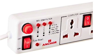

Actually Belkin should make surge protectors with LED Indicators like image below, MX Also make such but it’s cost very very high.
These surge protectors are just glorified extension boxes with some mosfets in them. Not worth the price. I have the MX 4 strip surge protector with mosfets and it just allows high voltage to pass through to any connected items.

yeah this! these indicators more like plug plates like this can also be used to check grounding and minute electricty changes. it comes in handy in rural/semi-urban regions for PC where electrical networks aint the best,
(there is a separate plug/device which comes which does same/similar job and they can cost nearly the same as plug plates like these).
sidenote the indicators used by local brands are sh1t.
that below image separate device missing **Line & Ground **Indicator, compare to above image Anchor Power Strip
idk why and what you were trying to imply here, exactly.
  • but i just wanted to say how come people just dont use plug plates with these indicators (good ones like from anchor, and not from local brand which use shit electrical components and indicators. there are local brands which makes such type of plates with indicators for 150-250rs ).
  • i personally have n use couple of anchor plates one is over decade old and funnily enough, it has helped me finding grounding issues in my home and leakage current related issues
    ( it doesnt directly tell oh hey there’s current leakage here,
    what i observed was for some reason as time passes during night or during the times when its water filling day the lights in the indicators glow up and up and when everything is quite down that is the water day is nearly over the glow in indicators vanishes this probably implying the circuit isnt quite balanced or there is some wiring issue. but this issue wont happen in other homes. there is one electrical issue so far we cant seem to fix/find probably would need rewiring of entire house which is something not want to deal with right now. why? cuz other important reasons,
water day? alternate days on which water is released and people use waterpumps/motors to collect water at homes)
they,these plug-plates are ofcourse not replacement for better/good quality instrument which are MADE to detect electrical faults (and here, no i am not specifically referring to mx-1177, i am referring to devices used by home inspectors)
hmm my bad… as you didn’t provide any images of device for reference and I thought that proper image will help your post, as if , someone after some time, months, years visit this thread than no need to explain again just a good detail product image is more than enough
