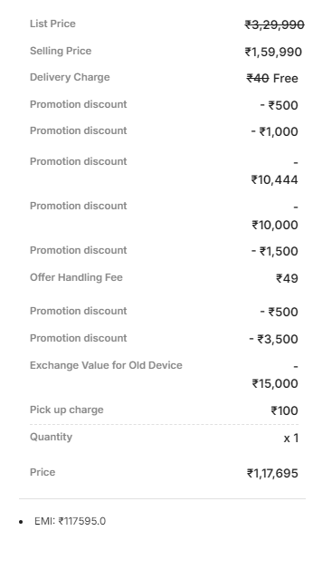

I ended up ordering the 75" TCL c755 from Flipkart for ~ 1.28L as Amazon had that size unavailable in my area. Flipkart also offered me 15k for my 2019 Flipkart brand LED TV!
If I can figure out how to prepay the no-cost EMI, I may be able to get this down to ~ 1.21L. Thanks again @@moh1t
