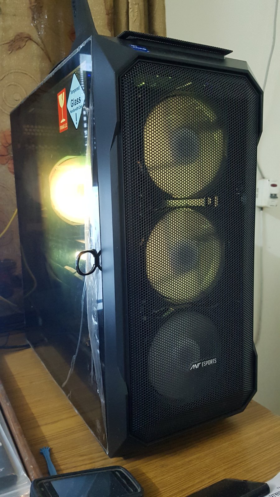

Case ? Fan setup ? Some pics of your setup would help although I suspect the termite of a CPU cooler.

Share more details and photos of case and cpu cooler cooler…
here is the cabinet ,
hahaha , didnt expect that honestly
above ^^ :slight_smile:

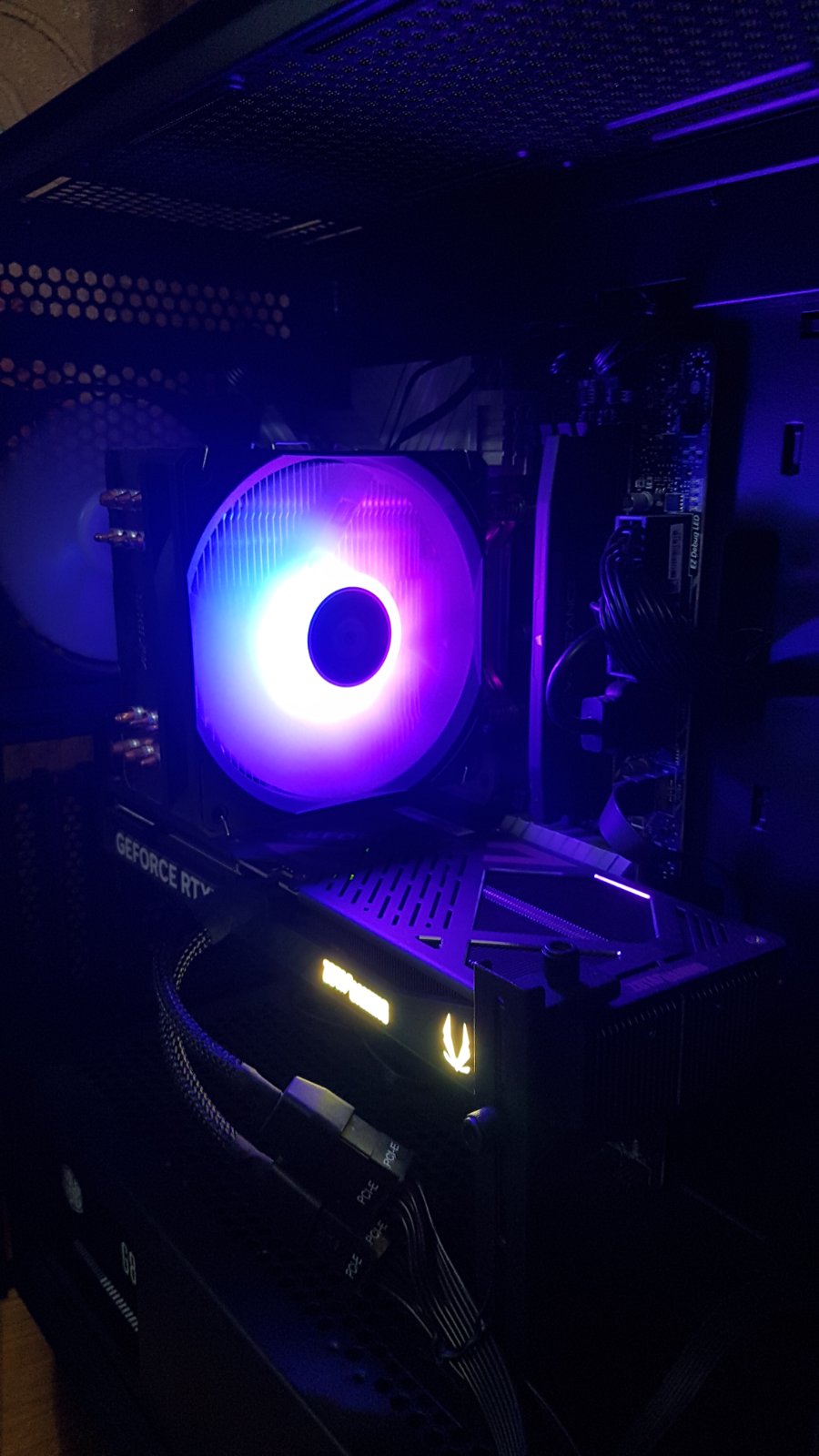

What cpu cooler?
That cooler lmaooo
  1. You need a contact frame + a 360mm AIO for a 14700k.. or at the very least a top of the line air cooler like the Noctua NHD15.
Goto your bios settings and select intel defaults.. turn off all core enhancements/default motherboard overclocking features.. there are plenty of threads on reddit explaining how to do this.. you’ll also find plenty youtube videos for the same.
this one
You need to squash that ant. Get something like an AK/AG620 at least, for a 14700K.

honestly ,the shopkeeper gave me cooler master twin tower with twin fans thing ,but he said this ant esports will work too, so i took this , i didnt know about i7 heating issues with graphics card since till now i was using laptop only ,a basic one for work related things ,
also i was concerned about my ram slots not getting blocked by cpu cooler ,hence this too for that moment i took
