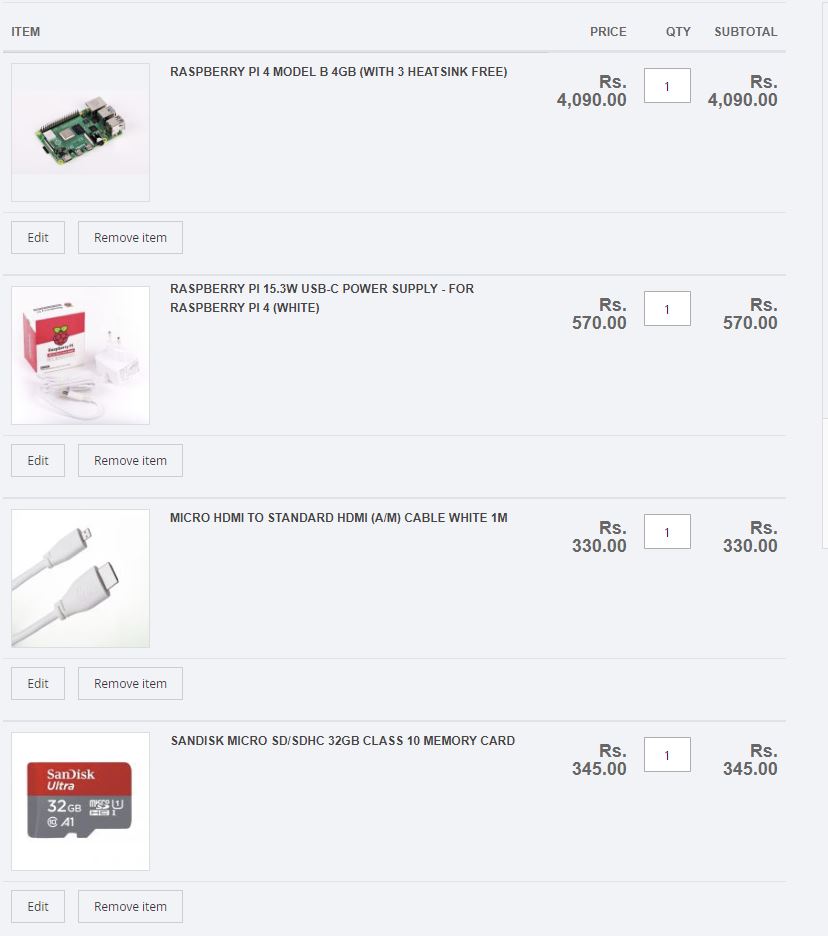

See this image- this is form a local dealer ( final price for the board he quoted is around 4200 inc tax) , i had one more who is providing even in lesser, but they didn’t had Cf card in stock, else would have saving another 300-400/- in the whole kit.
I was about to impulse buy yesterday night itself then stopped.. as i got confused to with with 4gb model or 8gb model which pricing difference is only ~1200/-. but today again decided to go with 4gb, as im not sure i will run x64 but stuffs into that. I will go with DietPi without GUI, so even considering to drop HDMI.
The PI Box combo that I linked above, I used a coupon in cart and was then able to get final price to **5,639.00 (including GST).
@@netant how does one find local dealer? I am in Mumbai. I was not even sure if I can get it locally and with all lockdown here, it is probably impossible unless he can hand deliver at home.**
see this - https://www.silverlineelectronics.in/raspberry-pi-4-model-b-4gb-starter-kit.html ( but again out of stock) , this is final pricing.
sorry - when i say local dealer means shops form Bangalore. I search online and called them :slight_smile: here is SP road we might even get a better deal, specially cases .. but shops are closed now.. and police will paint our back in red if we step out :slight_smile:
btw 5600/- is good pricing – if you want those actual items.. i would like to select item by my own, specially want to go with official power adaptor.
I am doing what you said exactly. Selecting one by one everything (on different websites) for all those included items (or at least what I need bare minimum) and see what price I get compared to this 5600 combo. Chances are some things in the combo may not be used but I feel finding things separately is going to overshoot the 5600 price.

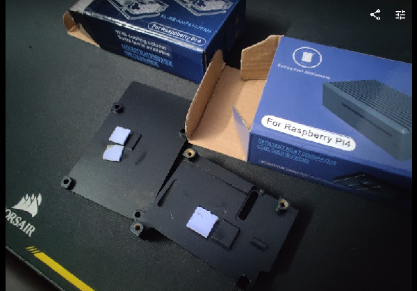

Passive Case
The passive case doesn’t need the tiny finned heatsinks.
This is a case I retired as it didn’t cover the USB ports. See the metal protrusions from the body of the case which wick heat away from the CPU and USB controllers to the body of the case itself. The purple stuff are the thermal pads.

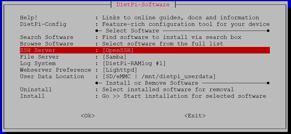

I went through one video which explains how to install dietpi headless. It pre configures wifi in a file on Microsd card before first boot.
Do I need to do this if I intend to use LAN cable to connect pi to router?
If my assumption is correct, I guess this is what I should be doing..
  1. Flash image of diet pi on Microsd card. Don’t change any file on it.
  2. Put Microsd in pi and also plug LAN cable and charger and turn in pi.
  3. Wait for say 2-3 minutes and go to my router’s page which lists all devices connected and find the Pi, say it has 192.168.1.121 as ip.
  4. Set a static ip for the Pi and bind it.
  5. Ssh into the Pi using default I’d password and continue from there.
Anything I mentioned wrong?
All your steps look good but the only thing that I am not sure about is SSH. I think we need to install a SSH server e.g. OpenSSH in my case. But I suggest you try it out first.
[mention]Marcus Fenix [/mention] But ssh comes pre-installed and enabled in dietpi setup as per their documentation.
