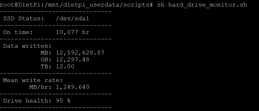

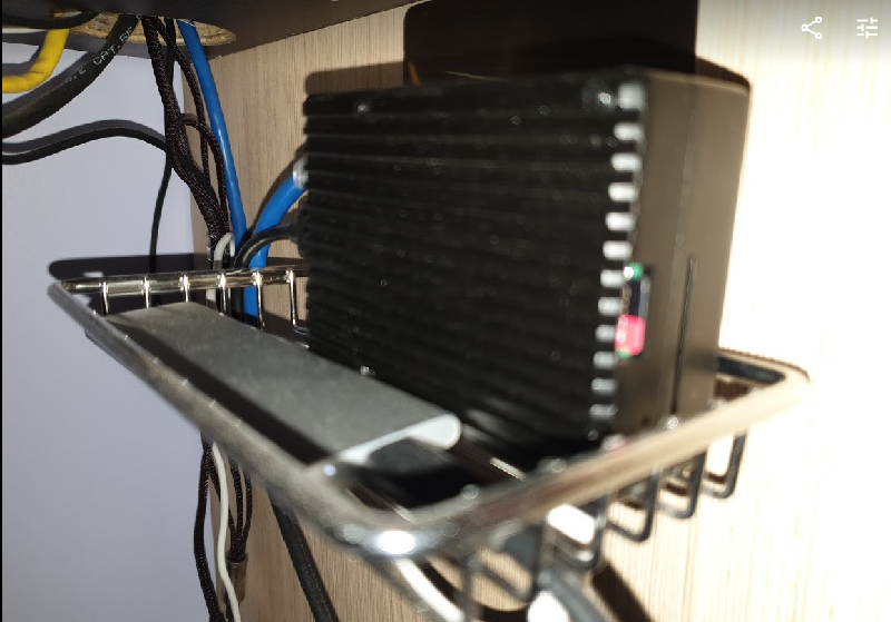

My Pi is tucked away beneath my PC desk like this with a 250 GB SSD.
I use a soap holder for the Pi. :face_with_tongue:
https://www.amazon.in/gp/product/B07BPT2MCH/ref=ppx_yo_dt_b_search_asin_title?ie=UTF8&psc=1

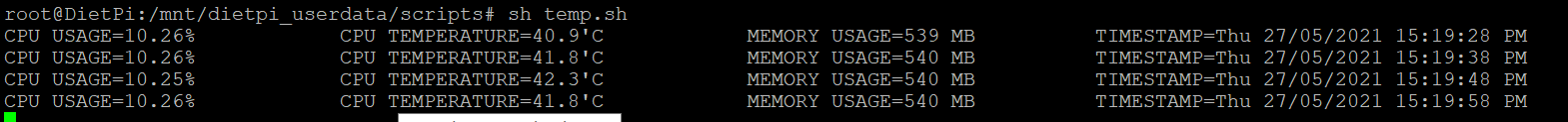

Temps are pretty good as shown below.

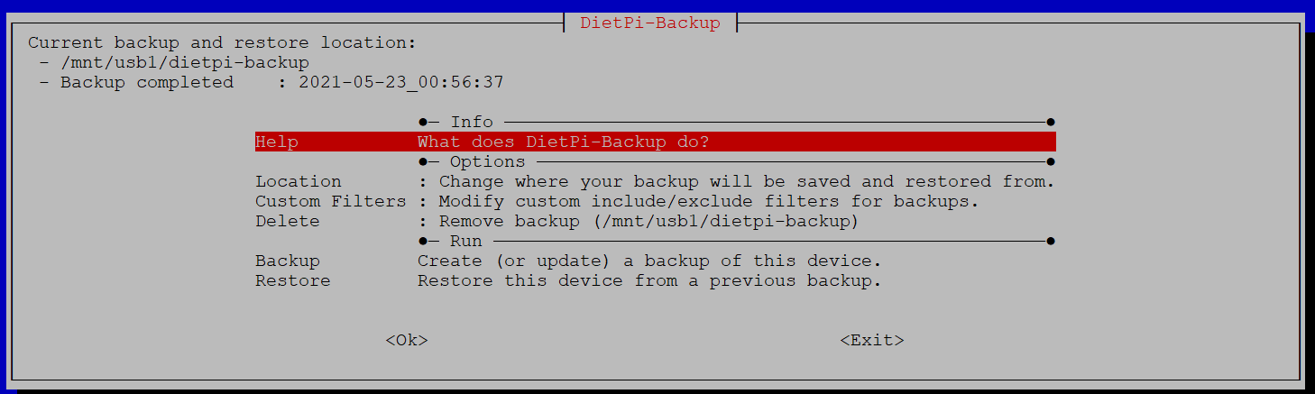

Dietpi gives us the option of backing up the existing installation which I save on the external SSD via dietpi-backup. If something happens to the SD card I can write a fresh image to my spare SD card, pop it in the Pi 4 and run restore to get back my setup in its entirety.

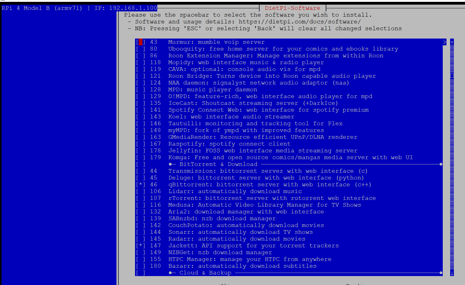

Dietpi standard software installation is very simple as you don’t have to go through a lot of github entries to configure your application.
Just go with dietpi-software and select what you want to install.
The for the default application setup details e.g. webUI port,default user/passsword etc. refer to this article.

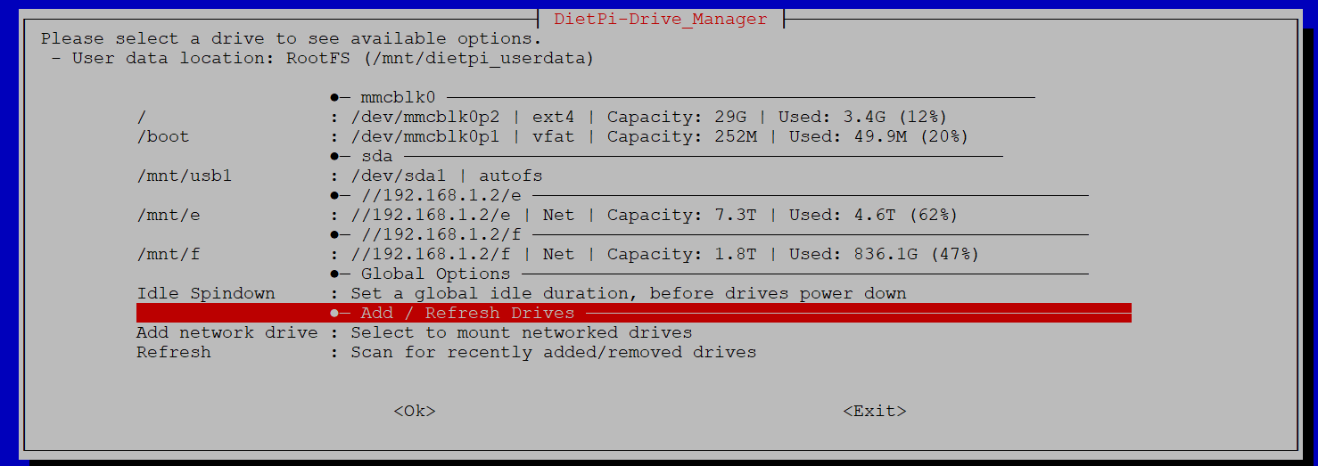

/mnt/usb1 is the attached 250 GB SSD and /mnt/e and f are the Windows file server shared drives.
In dietpi, run dietpi-drive_manager you will get options to format/mount the harddisk
