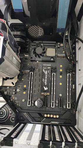

Board asrock x570 taichi

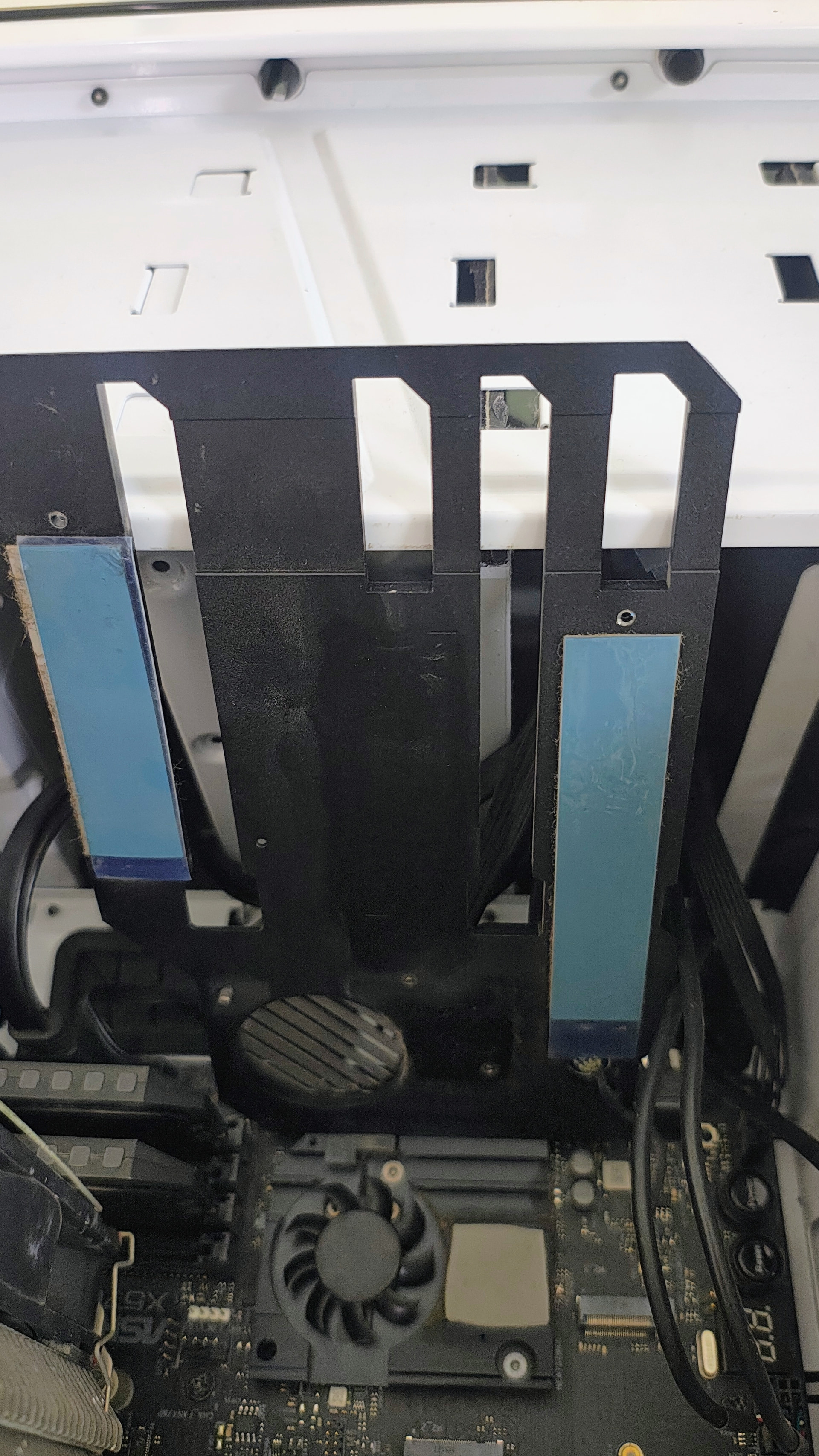

Nvme slot thermal pad had worn out, SSD was getting hot.
I need to buy some ASAP..please help, guide
This looks like 1mm thickness pad, you can order online and try both 1mm and 1.5mm for whichever fits better.

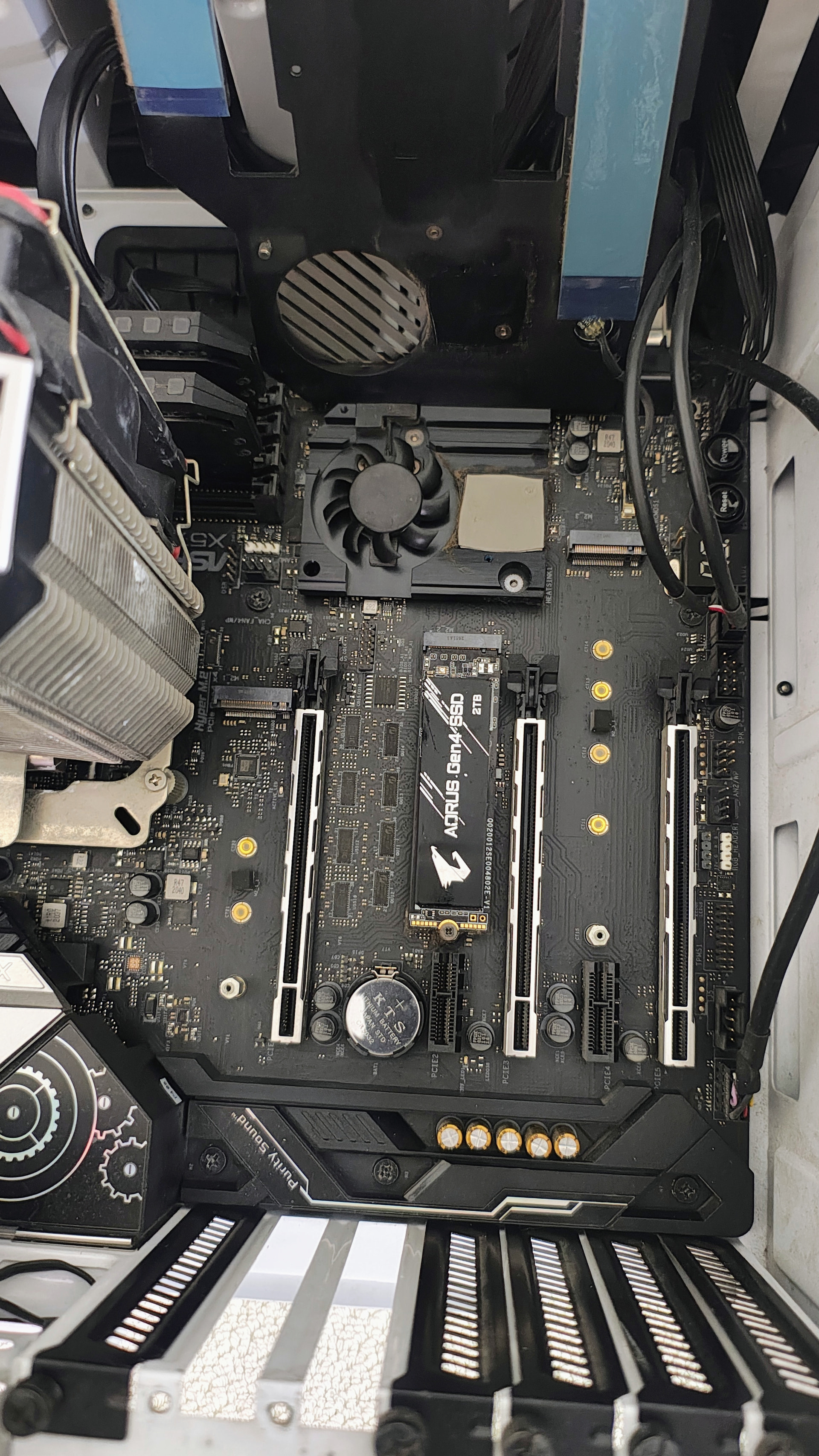

For now i have put the SSD in M2_1 slot, that has helped reduce the temps. I want really high quality ones so i can wait and buy. Let me search for the 1mm to 1.5mm pads.

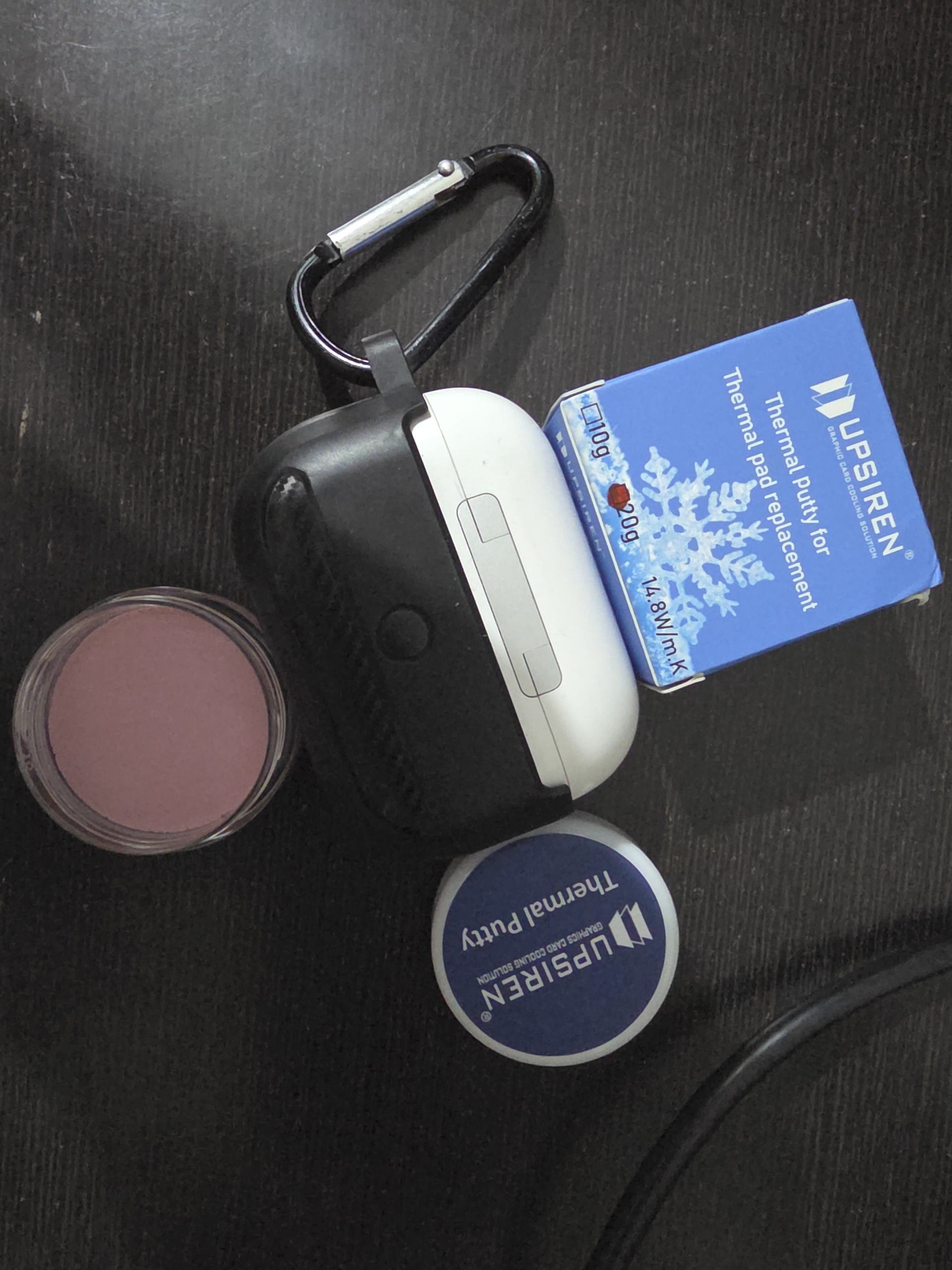

instead of thermal pads gets the putty. works a lot better and you can custom make it in all sizes
the only problem is its a bit costly. around 23$ for 20g
