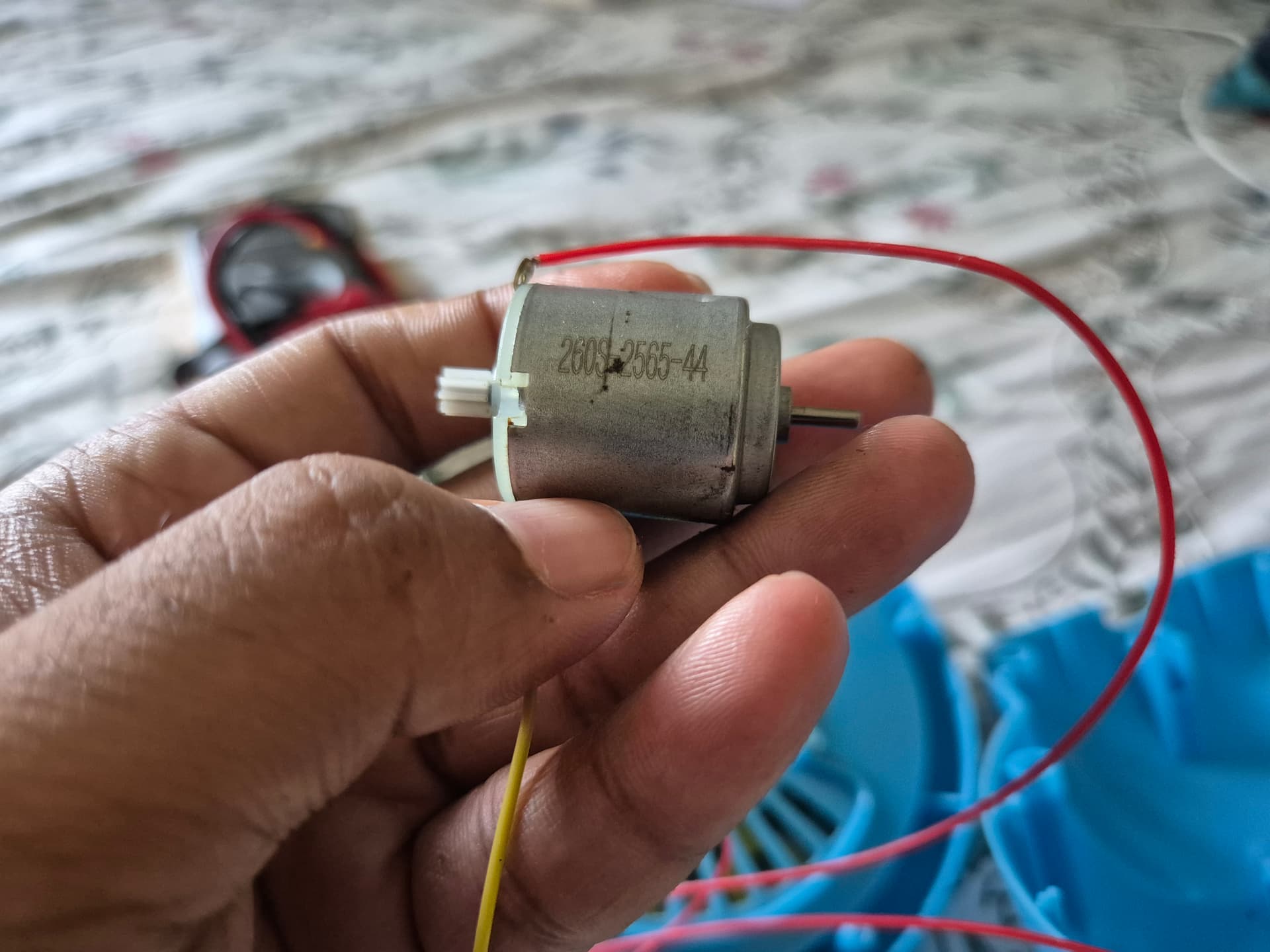

I am attempting to repair a toy bubble maker machine. Any idea where I can find this motor? It has a gear on one side and can accept voltage between 3DCV - 5 DCV.

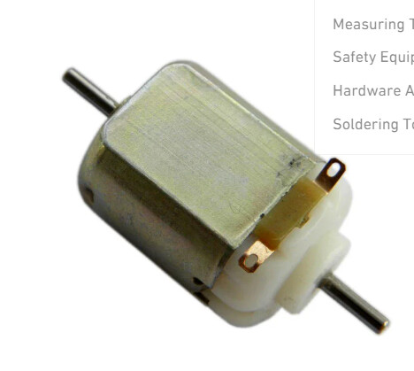

you can easily find something like this DC Toy Motor - Small Double/Dual Shaft High RPM DC Toy Motor (29 x 20
R260 seems to be the model of the motor. But this is kind of special one because it has shaft on both sides.
Normally we can get this here with shaft on one side.

What ever motor you replace it with, you have reuse that gear and hope it fits.
yeah difficult to find the exact gears used in toys , they come in so many different shapes and sizes
What you have a Type 260 DC motor. You need a motor with dual shaft something like this - PGSA2Z Metal Dc 3 V 12000Rpm Cylinder Micro Brushed Motor Double Shaft And Dc 1.5V-12V 6V 5400Rpm Dual Shaft Carbon Brush Mini 130 Dc Toy Motor : Amazon.in: Industrial & Scientific
You would need to use a pliers to remove that white gear from the existing motor and fevi-qwik it to the new motor.
You can get the gear 3d printed and then superglue it.
