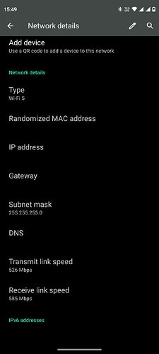

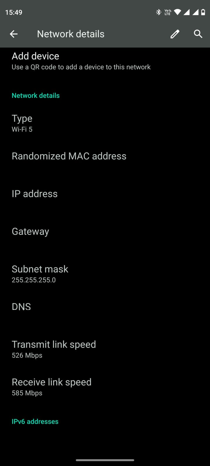

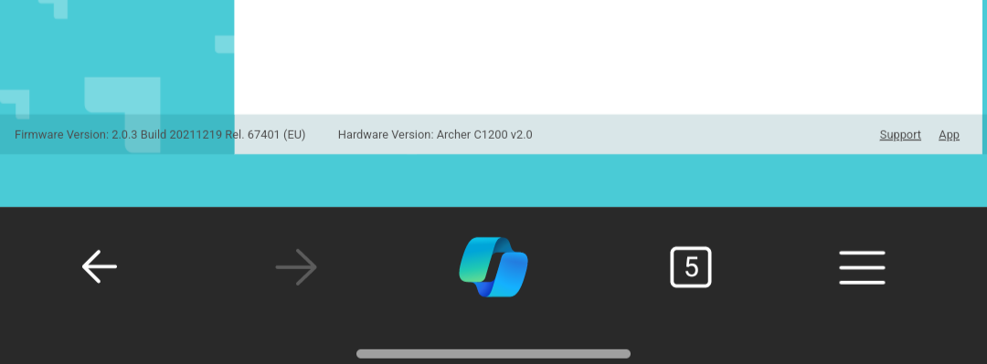

Hi, I have tplink Archer ac 1200 v2.0 version number and uplink/downlink speed in photo
Using phone, distance to router 5 meters and a wooden doors obstruction
That’s perfectly normal for a 1200mbps router. That 1200mbps means max speed of 867mbps on 5GHz band & 300mbps on 2.4GHz band assuming sitting in front of router in same room.
I wasn’t complaining about it, I was merely sharing my data and software version to op which may or may not be of interest to him since we have the same router
