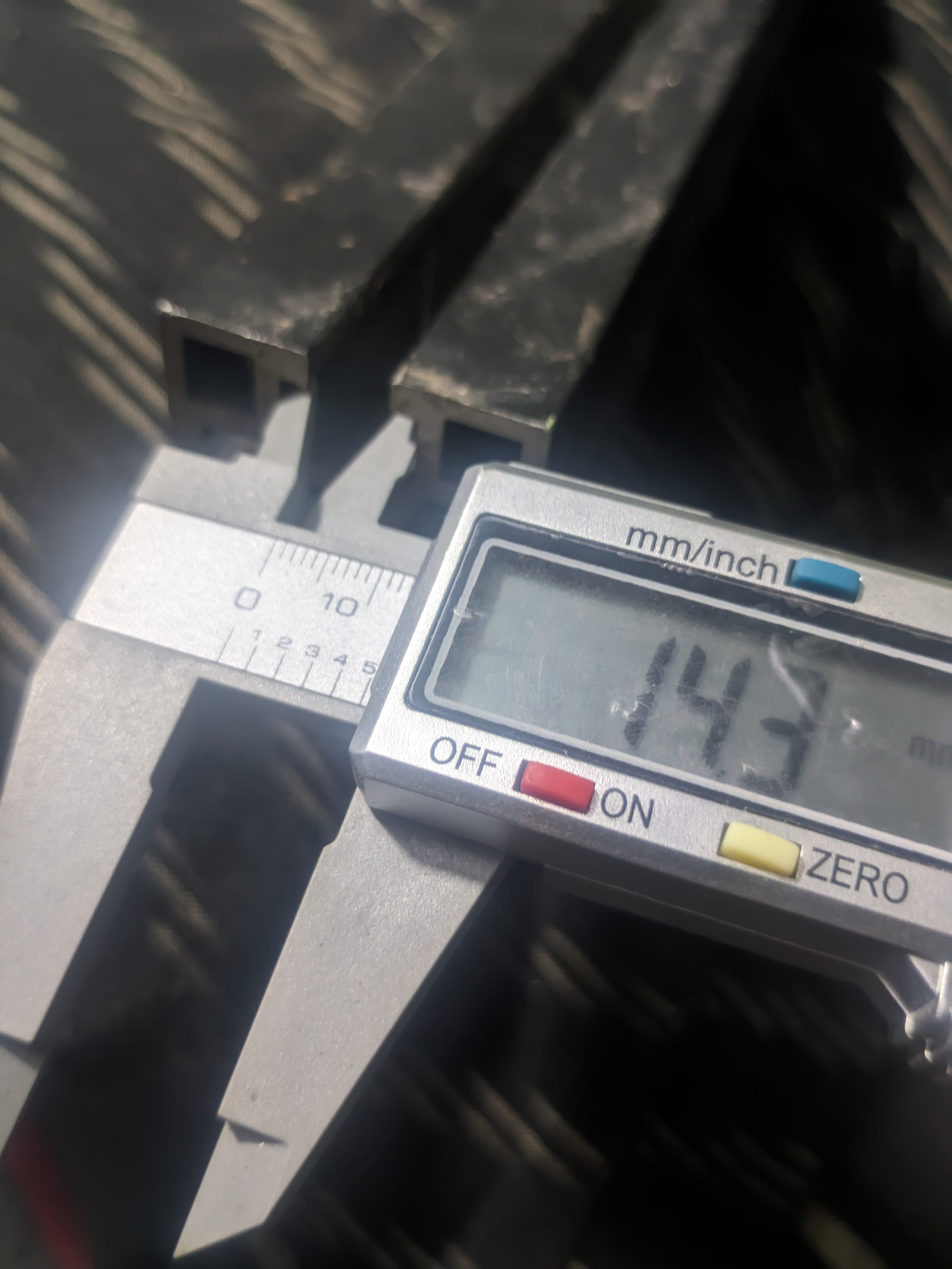

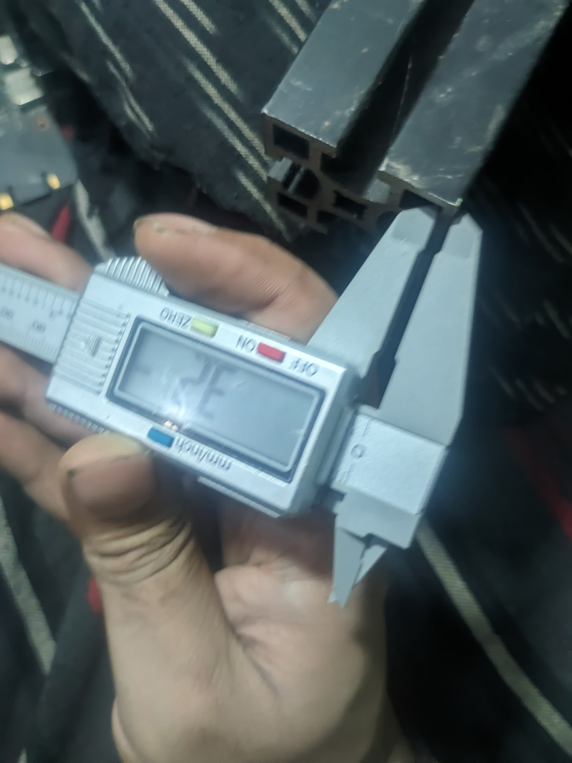

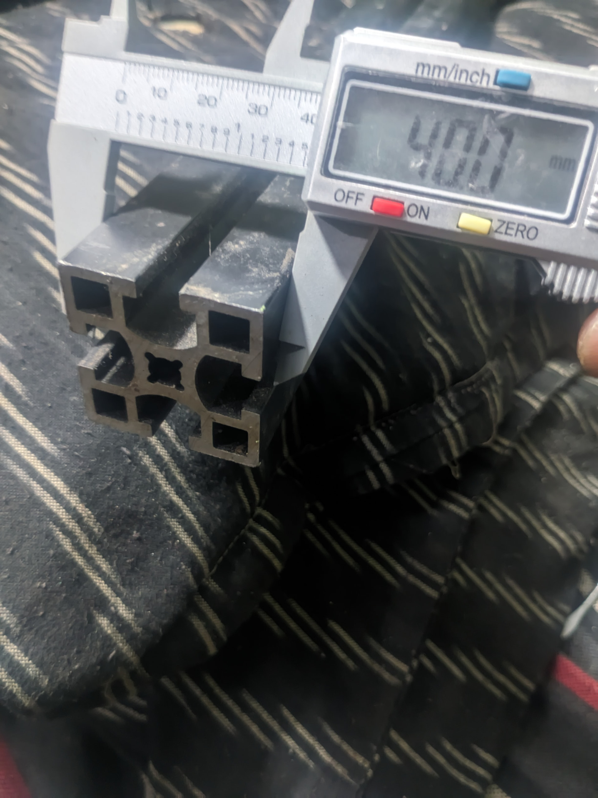

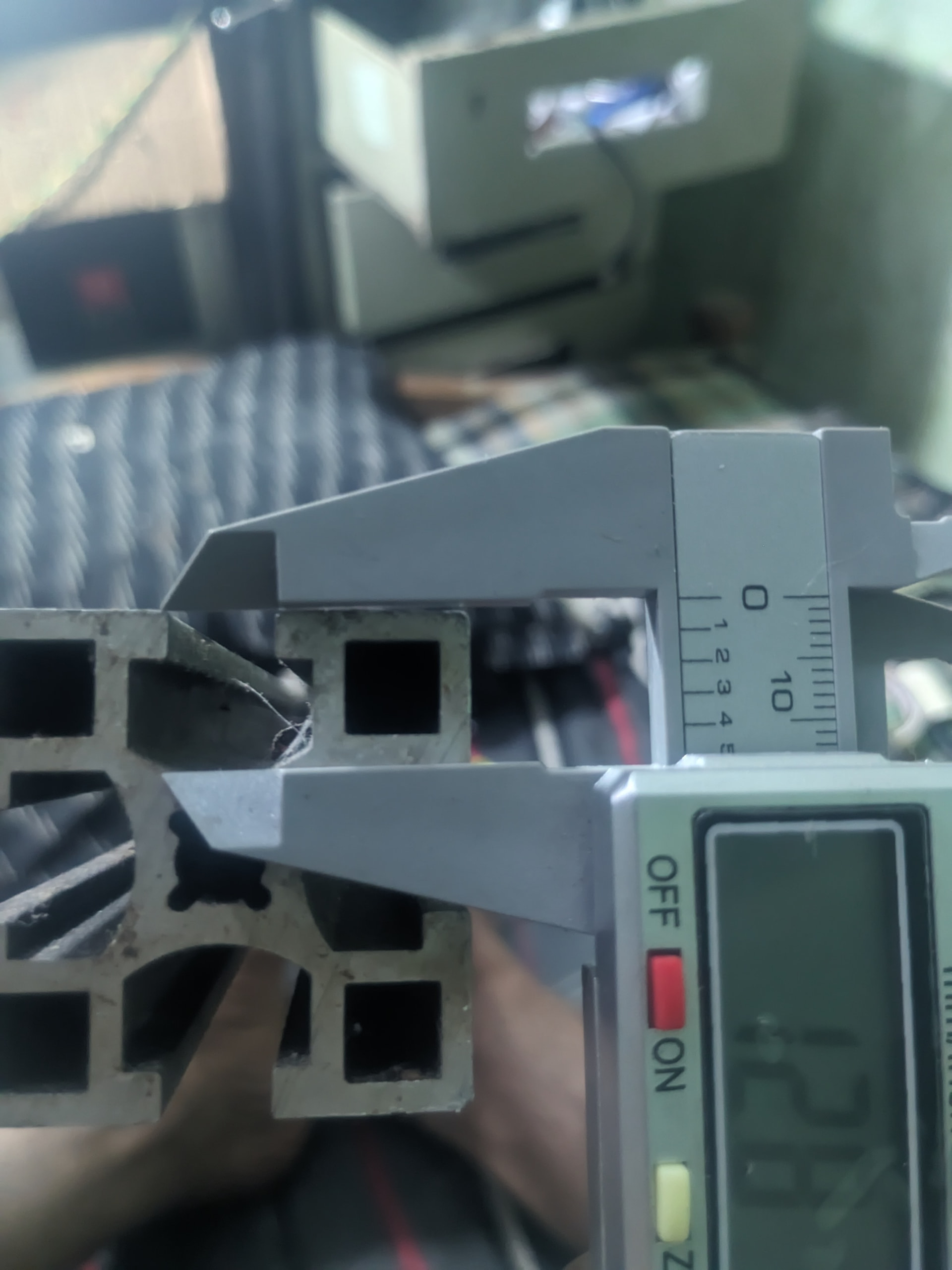

I’m building a diy bga machine and for the frame I bought some extrusions from a local guy. I didn’t check the dimensions and ordered the sliding nuts. But they were too big for the t slot. Sliding nuts were around 19mm in length and the width the tslot was one around 14mm. I couldn’t find tnuts that are compatible with this extrusion. Any idea what these are?

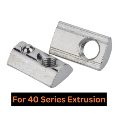

You’ll need the spring type nuts for the kind of extrusion you got, this stuff:
Or you could just drop in regular m8 hex nuts, looks this extrusion was designed for them.

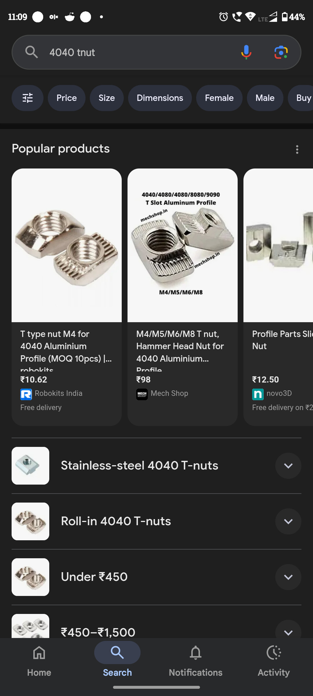

Thanks I’ll get m8 nuts then. Price for spring tnut seem too high
