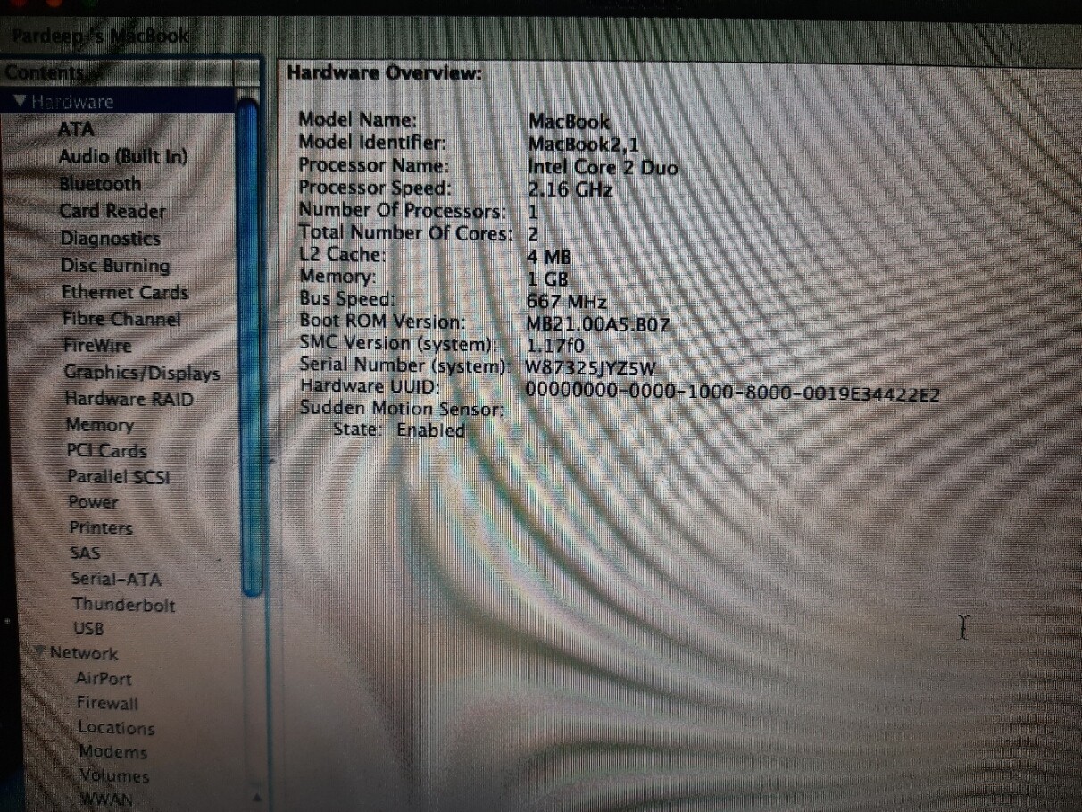

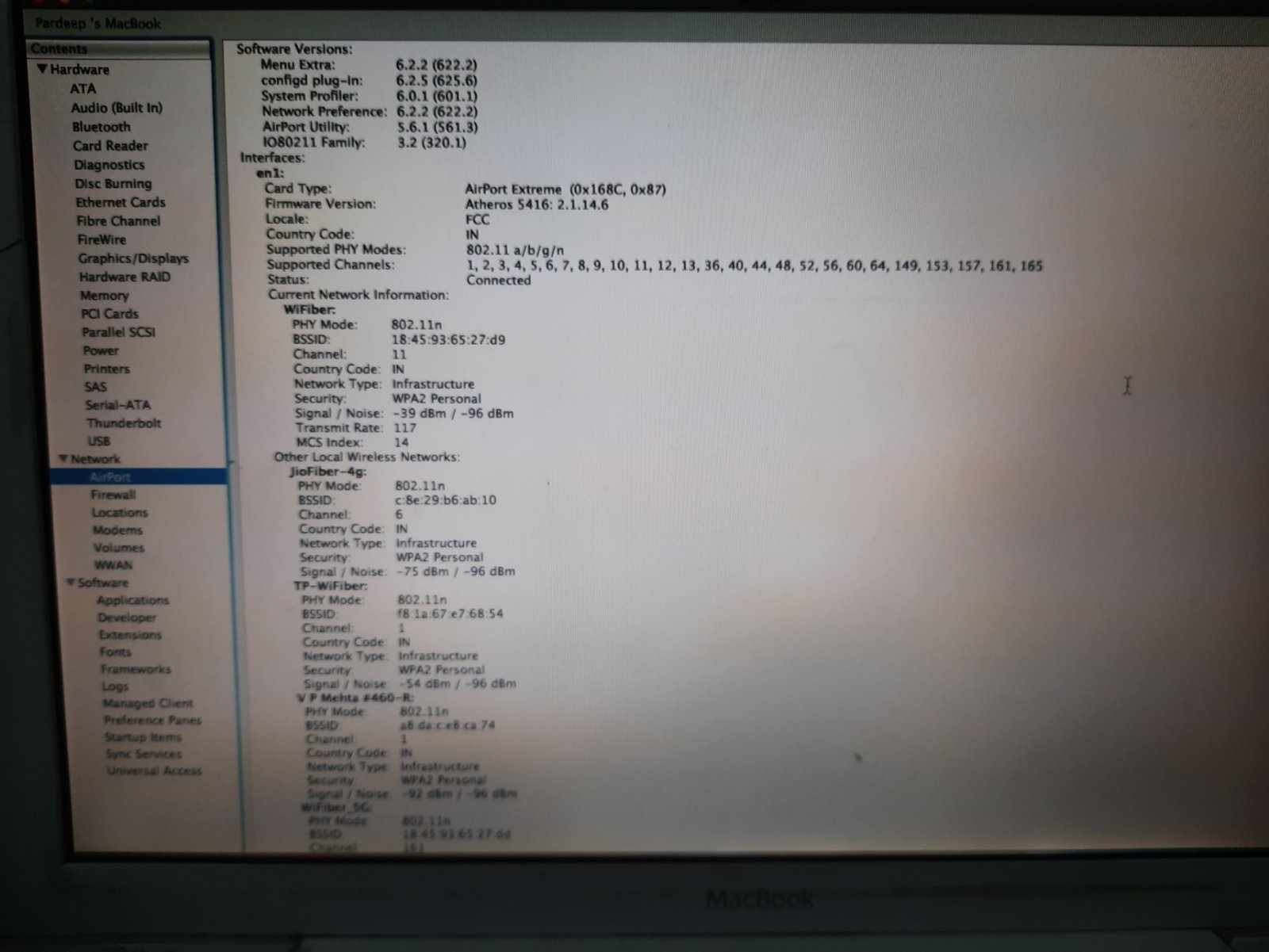

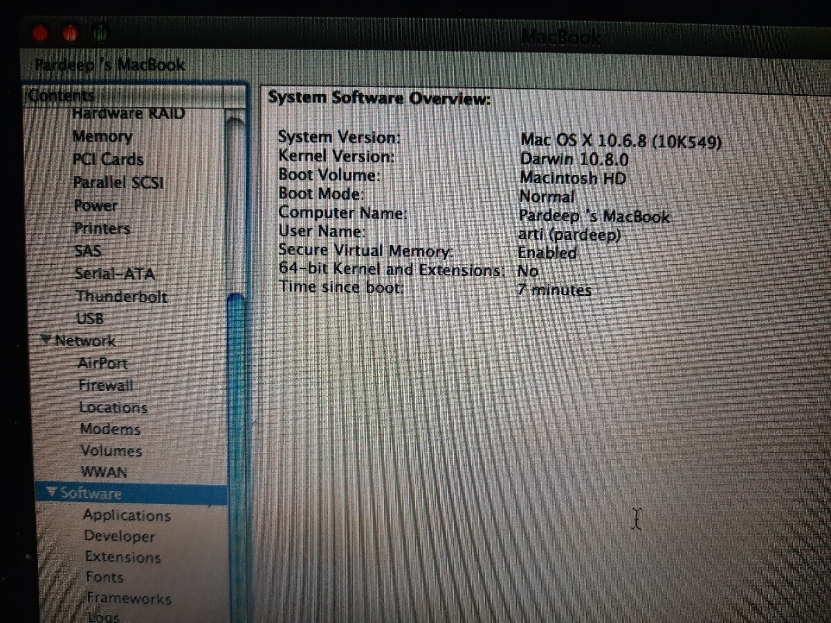

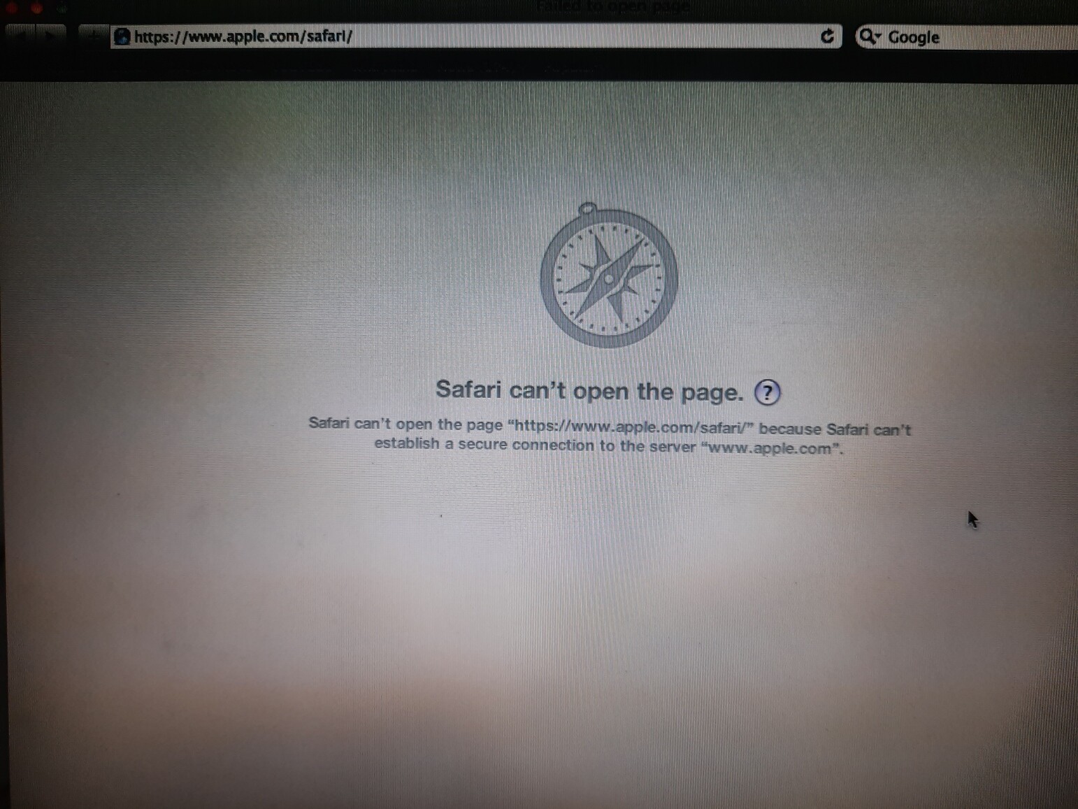

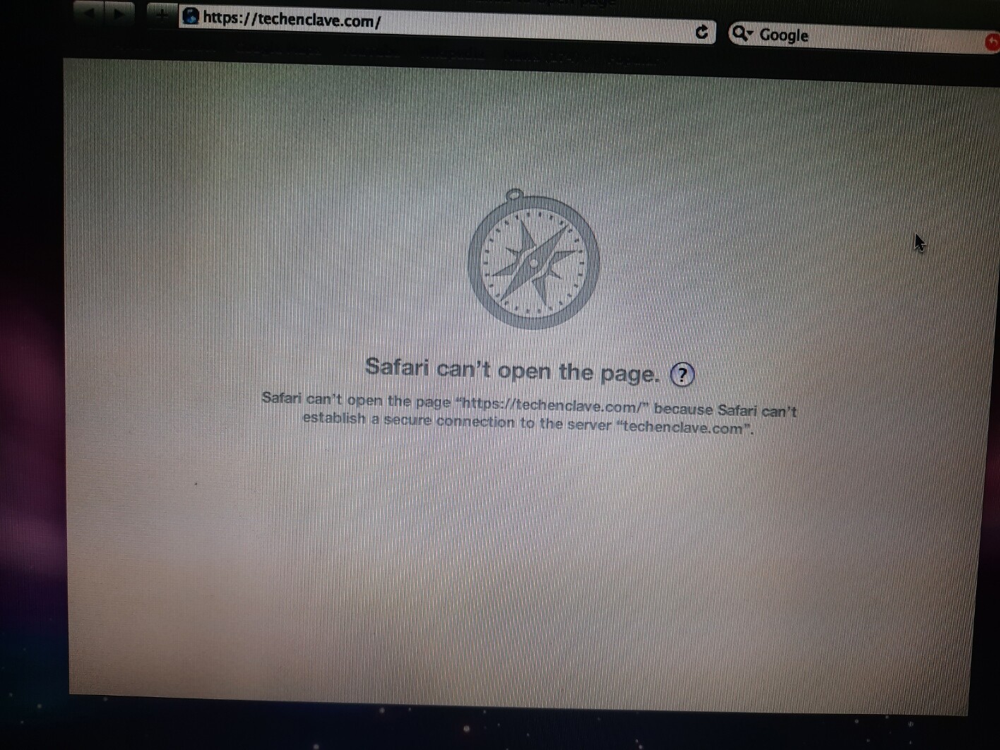

My wife has an old Macbook laptop, old being the keyword here. It powers ON, and almost everything works fine, except the battery, which is completely dead thus it works directly on mains power. To see if it can have any practical usage in the current time, I tried accessing Internet through the Safari and tried updating it but neither happened. Posting below the phone pics clicked of the system’s config and error messages. Please let me know if it can be brought up to the code of some degree of usability and if so then how. Attaching the pics below.

It is a core 2 duo and only has 1 GB RAM.
Those are very low specs.

1 GB RAM is way too low for Win 7. Add the ever expanding list of unsupported software and end of security patches to the equation. It’s going to be a painful experience.

Okay what’s the max amount of RAM that this particular Macbook supports?
Also, is that Core 2 Duo 64 bit capable? The Mac OS installed atm is 32 bit if I am not wrong.

It’s not worth it. Test it by trying youtube videos first if you can. A chrome extension called enhanced-x264ify might help in disabling some non-supported codecs and restoring x264 playback.
I was hoping to have just the software upgraded for it to be usable but going by the discussions it seems the hardware also needs upgrading to bring it up to the code. If that’s the case then I would keep it for a hobby project to be taken up at a later date.

AFAIK all core 2 duo series of processors supported x64.

That’s not due to the lack of x64 support by the CPU, but rather apple using 32bit efi bootloader. C2D is very much a 64bit capable cpu, I ran one for years on windows/linux flavors.
The apple 32bit limitation can be circumvented by using a 3rd party bootloader, like rEFInd with EFI stub boot of newer linux kernels.
Whether it should be done is a question left to the OP, but it probably can be done.
