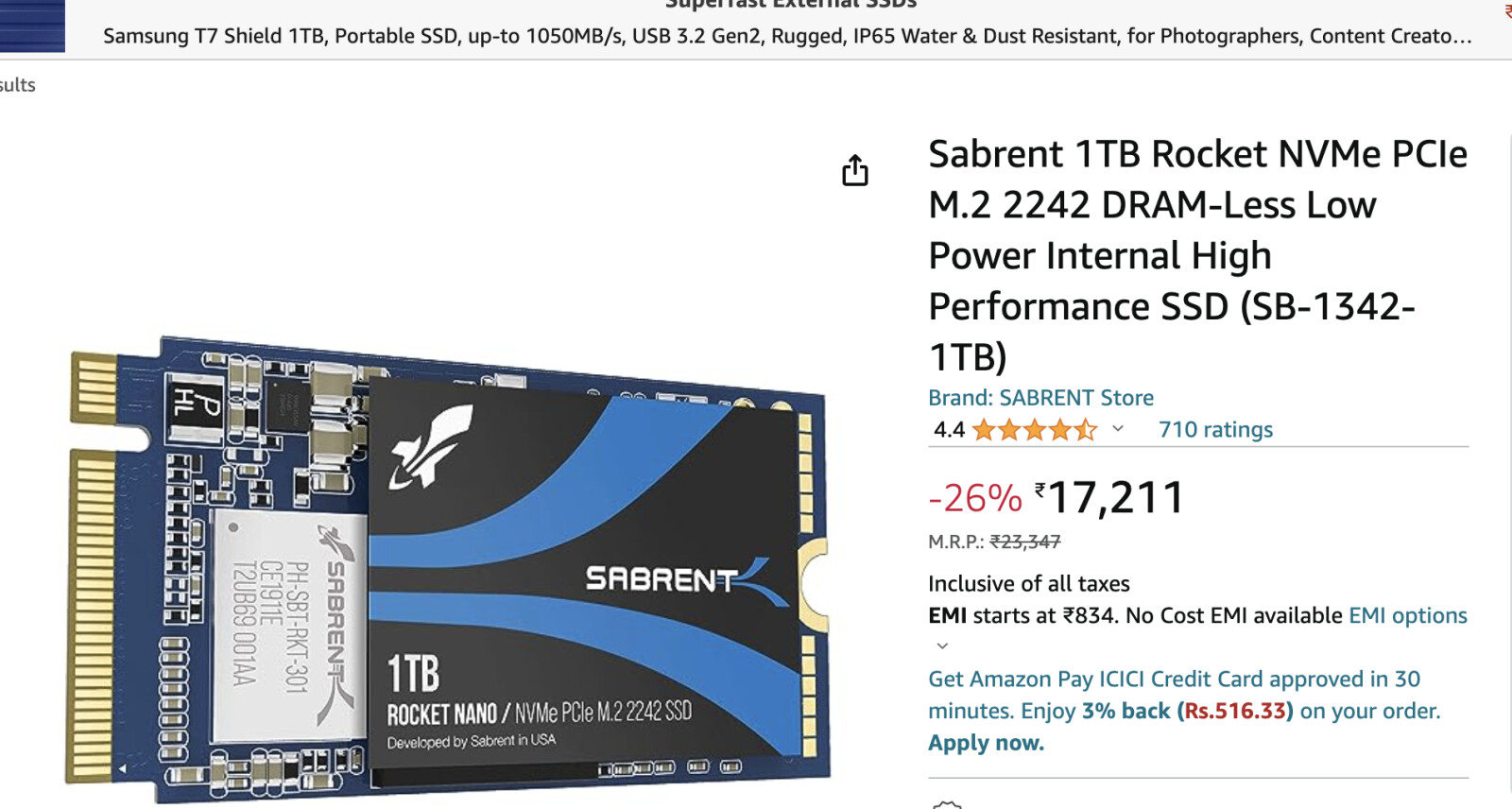

Most of the videos on YouTube recommend following SSD, which is availbe in about $100 in the US and Rs 17,211 in India.

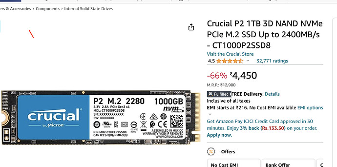

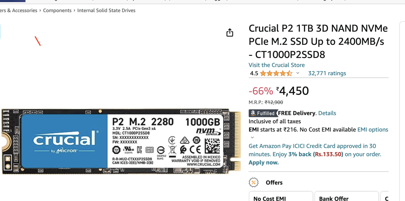

So I want to use following SSD. Are the specs same and compatible? Of course i need to use an adaptor to fit in Macbook Pro.
Please assist to clear my doubt. One of the user’s reviews in Amazon says it is used in Macbook Pro 2017.

1 thing is the size. Check what is existing size - 2242 or 2280. The recommended one looks like 2242 and you have selected 2280, which will definitely not fit.
Next is NVMe / Sata. I wouldn’t change the type.

  • You can technically use a 2280 NVMe SSD (like the Crucial P2 you mentioned, albeit it’s a really mediocre model) with a suitably sized adapter and use some thin double-sided tape to stick it, it’s recommended to opt for the standard 2242/2230 sized adapter for factors such as stability and compatibility.

I have selected the following adapter to use with Crucial P2 SSD.
https://www.amazon.in/gp/product/B096G2P8KL/ref=ox_sc_act_title_2?smid=A3H89GH4UYZJ49&psc=1
Price-wise, it seems EVM and Crucial are almost the same for 1 TB SSD. Why gamble with data? Any chances of crashing later? I will take a back up in the Time machine before replacing the SSD.

As you can see, there are two screw holes in the adapter. The first one is 30 mm from the M.2 slot, hence you can mount a 2230 SSD on it. The further one is 42 mm from the M.2 slot, so it’s suitable for a 2242 SSD. The Crucial P2, on the other hand, is a 2280 card, so not only it will stretch beyond the adapter’s PCB (more than 40 mm), but there are also chances of getting the surface scratched from the standoff.
