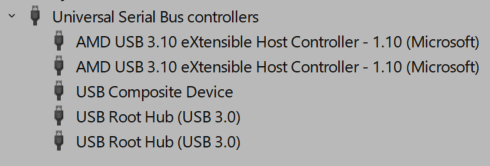

This is how it looks in a windows laptop:
Above means both usb 3.0 ports can run at 5gbps each because both are connected to their own usb root hub.
