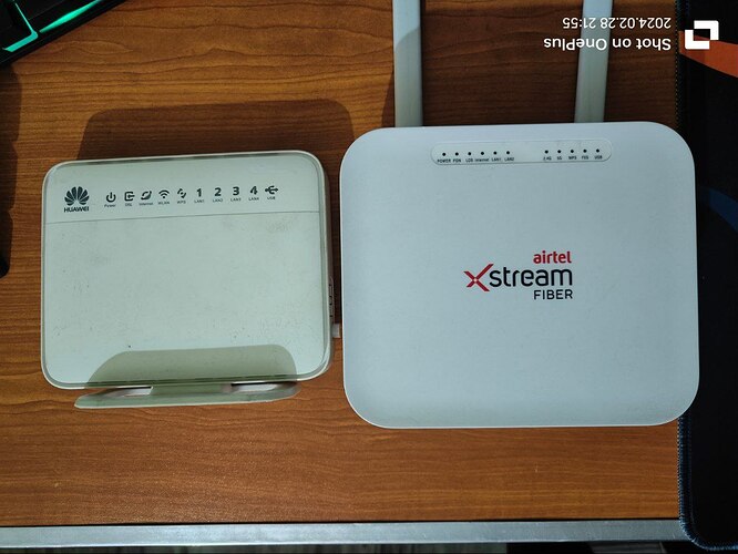

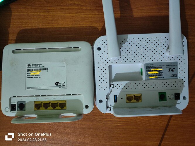

I need wifi for my PC. I can’t bring a LAN cable from my Jio router as it is around 20 feet away in another room.
Now, that I have these 2 old routers, can I use them as wifi extenders/access points without connecting them to the Jio router?
I don’t know if this is even possible with these, don’t want to buy a wifi extender.
Might as well buy Tp-Link AC1200 if nothing works.
Extending signal wirelessly with these ONTs is not possible, these are not designed to work that way.
Now, I wouldnt recommend you extending range wirelessly as it will attract wireless noise and speed wont be good. You can disable DHCP server in any of these ONTs and connect LAN to LAN(Jio ONT to Airtel ONT).
Nope, they would have locked down custom firmware so not possible.
Also you won’t have a good experience extending wirelessly a signal which you’re getting 20 feet away from source.
You’d be lucky to even get 40% of the speed compared to source and the latency would be horrible.
Yeah… I would also suggest to rather get a long LAN cable. As it’ll be more more faster than a wifi extender. I also have a 20ft cable, works fine.
I tried following the tutorials on YouTube for both routers, but even after following it all, there was no success.
Huawei has an option for the WDS bridge but does not seem to work. A similar feature is in the Airtel router too.
