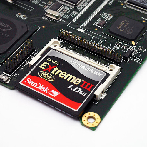

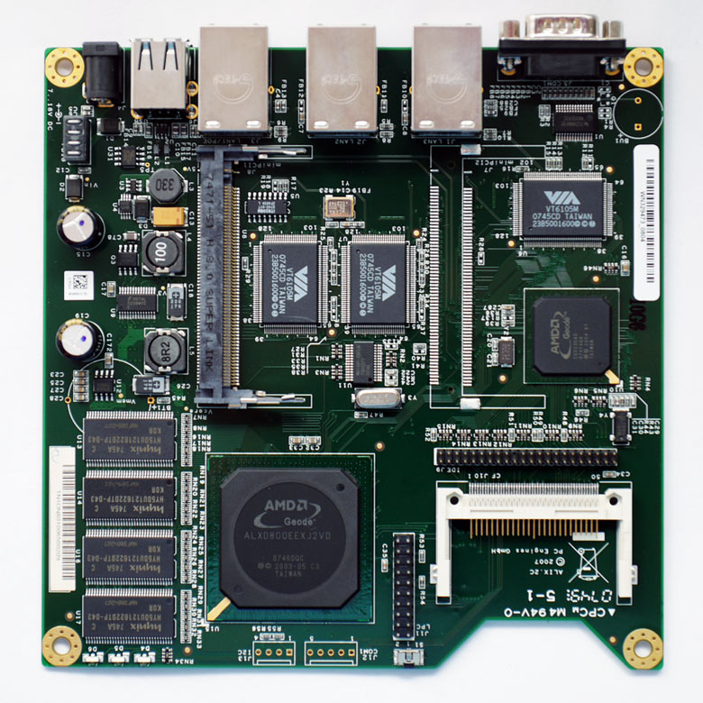

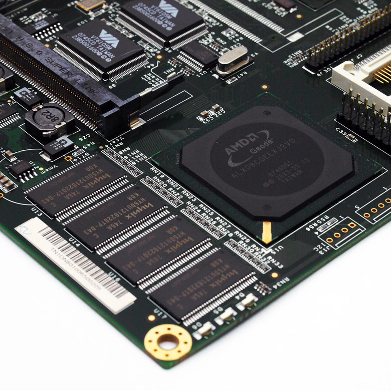

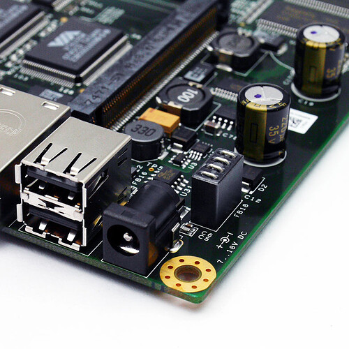

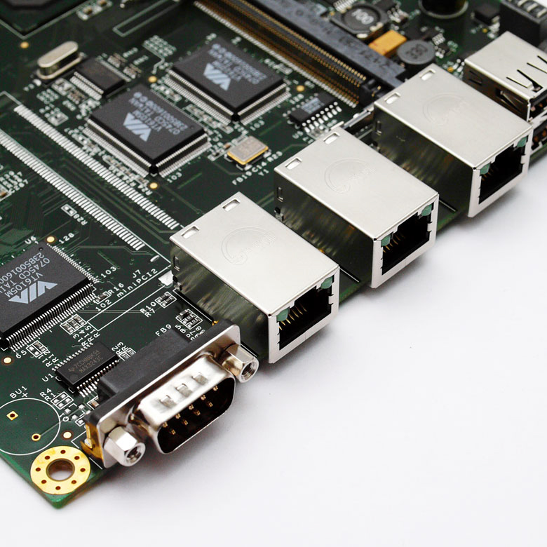

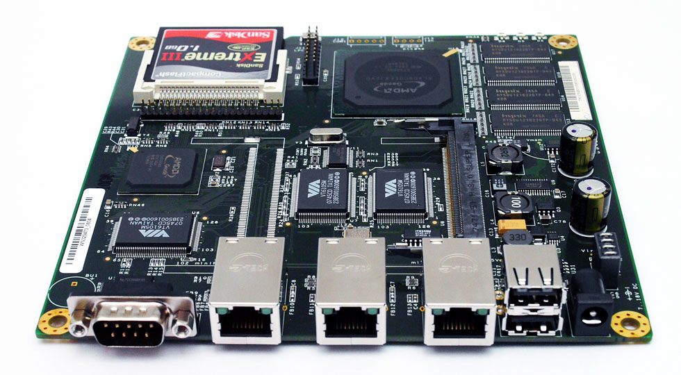

Let’s go back in time to 2008:
This was amazing with m0n0wall way back then.
Oh my heart. Brb, need a breather.
