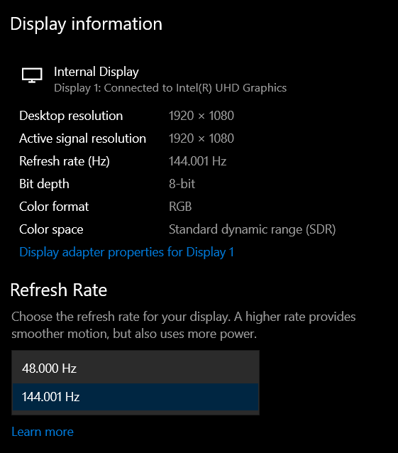

  • This laptop display shows only two refresh rates i.e 144hz & 48hz in Windows display settings, I am unable to change the same in advance graphics settings

Also the display properties show as display connected to Intel UHD graphics, is this correct
Yes. Your internal display is connected to the dGPU via the iGPU since it does not have a MUX switch. My RTX 3060 laptop also shows the same, nothing to worry about
