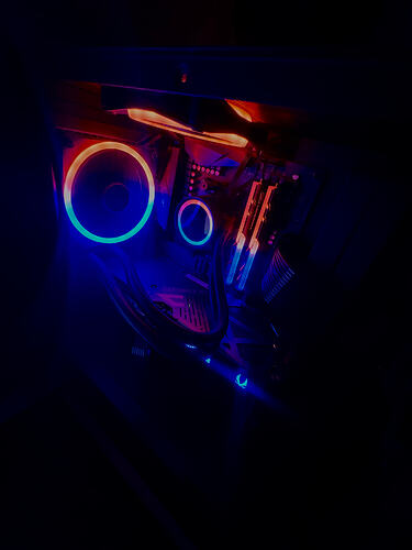

Just sharing my current build rn. tell me what you think?
