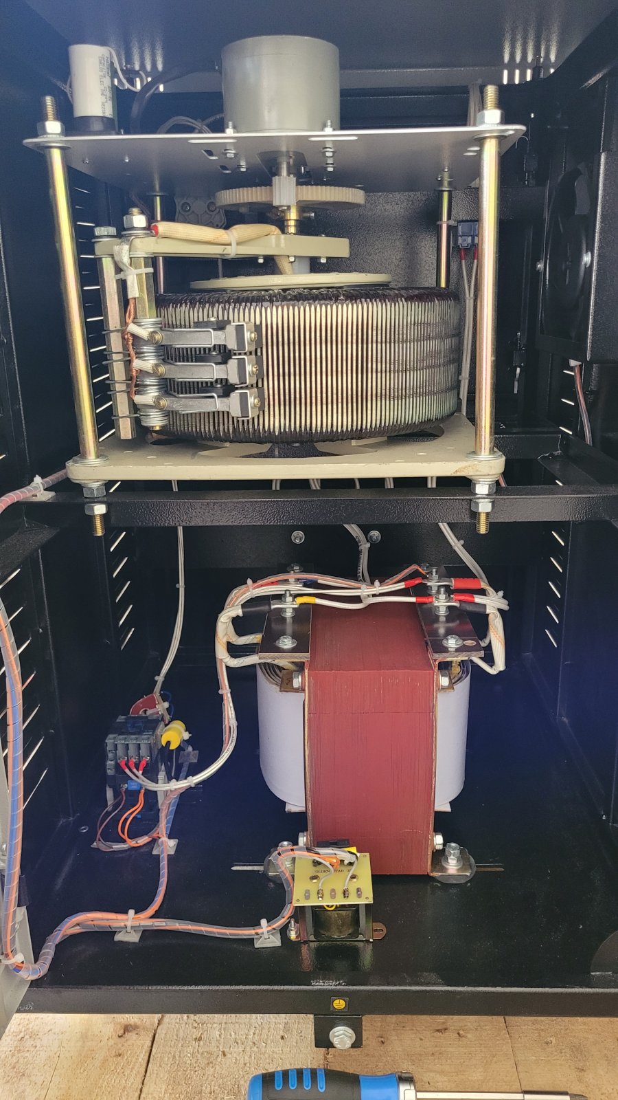

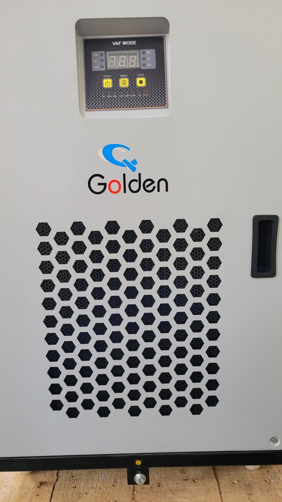

I had numerous issues with Aulten 10kva stabilizer. Their support(and sales dept!) was terrible so I returned it and bought a servo stabilizer from golden servo. This new stabilizer will be installed either today or tomorrow.
Ishan… What is the capacity along with price !?
Please also post your experience after using for a week when normal voltage in the range of 200-240. Thanks
This is 10kva servo stabilizer. Normally, such stabilizers have input range of 170-270V but I get lower input voltage so this is custom built to work in 110-270V range.
170-270V range stabilizer costs around 25k and this stabilizer cost me 45k + 4k transport charges +gst. (Volumetric weight was 140kg and it was shipped in a wooden crate)
This is calibrated to output 230V ±1% (vs 200-240V ±5% in step stabilizers) and it will not have any fluctuation on the output beyond the 1% unlike step stabilizers where the output fluctuates a lot.
the product page is here,
http://goldenservo.com/1phaseservoair.html
I am expecting everything (inverter ACs and some other stuff) to work without any problems unlike all the issues I had with step stabilizers and I’ll share my experience in a few days.

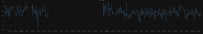

It’s a little early but so far it looks great!
I so wish I had a similar screenshot when I had aulten stabilizer installed. It had so many spikes every few seconds or minutes between 190-235V (when input voltage was between 150-220V)
This is the voltage range with servo stabilizer when input is between 150-220V. My sensor is not super accurate, it’s off by about 2V. (I tested separately with fluke multimeter and the real voltage is around ~229-230V when sensor is reading 227.5-228V. The screen on the stabilizer reads 229/230V)
The biggest drop closer to start of the graph is when I turned on ~2KW submersible pump

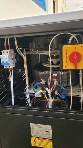

I am getting 90-100V input today. Stabilizer was working until 105V and it cut off output after that. At 105V input, it was outputting ~220V. AC etc were working perfectly fine at that mainline input voltage.
On low voltage cut off, A buzzer goes off that can’t be disabled from the control panel. I’ll probably disconnect it internally because it’s quite loud and unpleasant. A short video of this
https://www.youtube.com/watch?v=KW6RF7W0chc
Had a similar issue on mine. I asked their technician to take out the speaker from the PCB. No more irritating beeps
