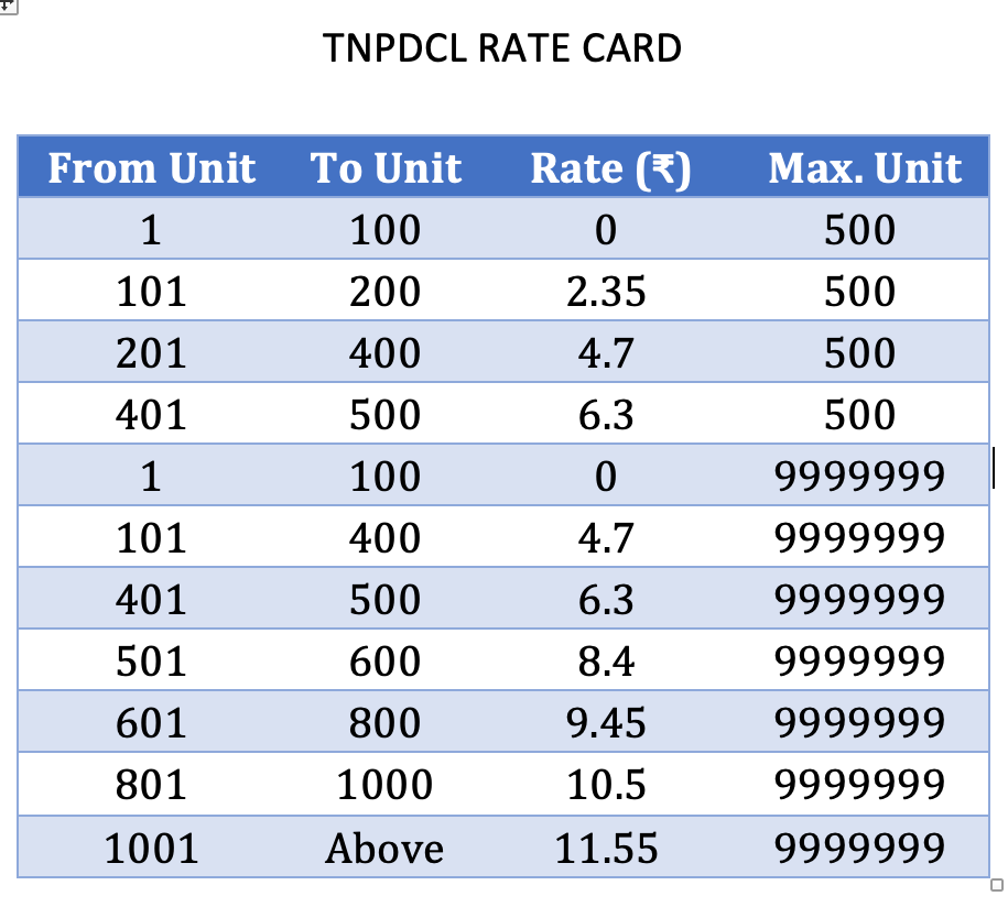

I live in Chennai and consume around 1100 kWh per bimonthly cycle. Below is the TNPDCL tariff structure for reference:

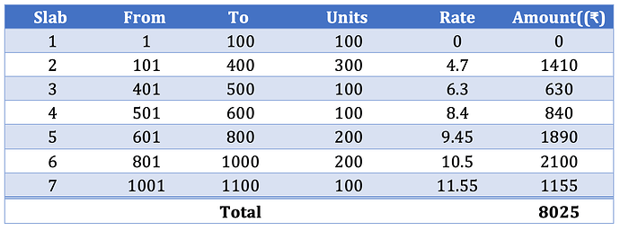

With 1100 units consumed, my bill totals ₹8,025 per cycle.

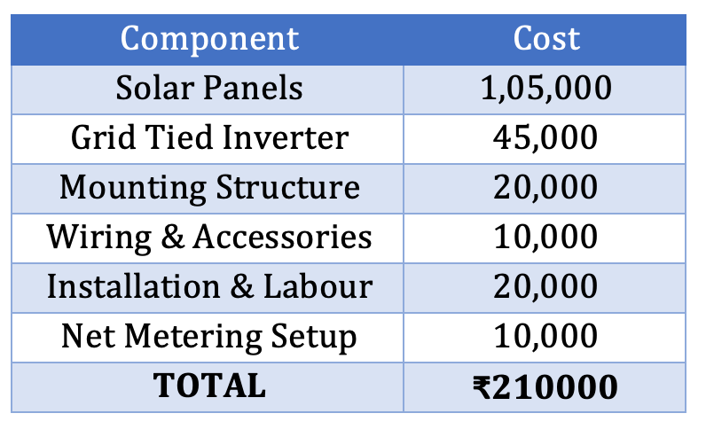

Now, let’s break down the cost of setting up a 3 kW plant.
With the govt. subsidy, [PM Surya Ghar scheme](’
National Portal for Rooftop Solar - Ministry of New and Renewable Energy
), I’ll be getting ₹78,000 back, bringing the net investment amount to ₹1,32,000.

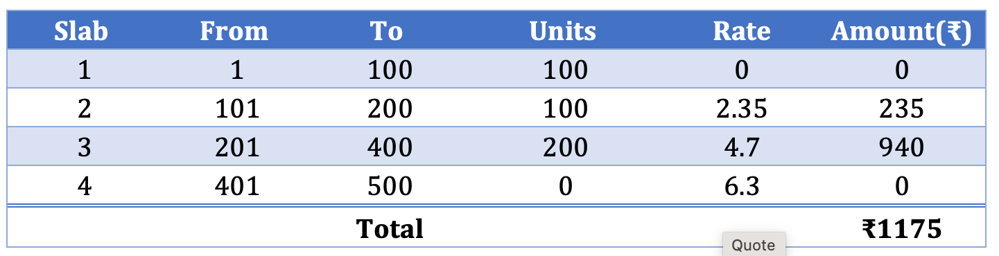

Now let’s compute the new bill. The 3kW will generate at least 4 x 3 = 12 kWh /day, or 720 units /bimonthly cycle. So now, I’ll only pay for 400 units instead of 1100.
With an annual savings of ~₹40k, the system will pay for itself in approximately 3 years, after which all savings become pure profit. Since solar panels have a lifespan of ~25 years, this translates to decades of reduced electricity costs. During peak summer, the system can generate up to 16 kWh/day, naturally balancing out higher seasonal electricity consumption.
