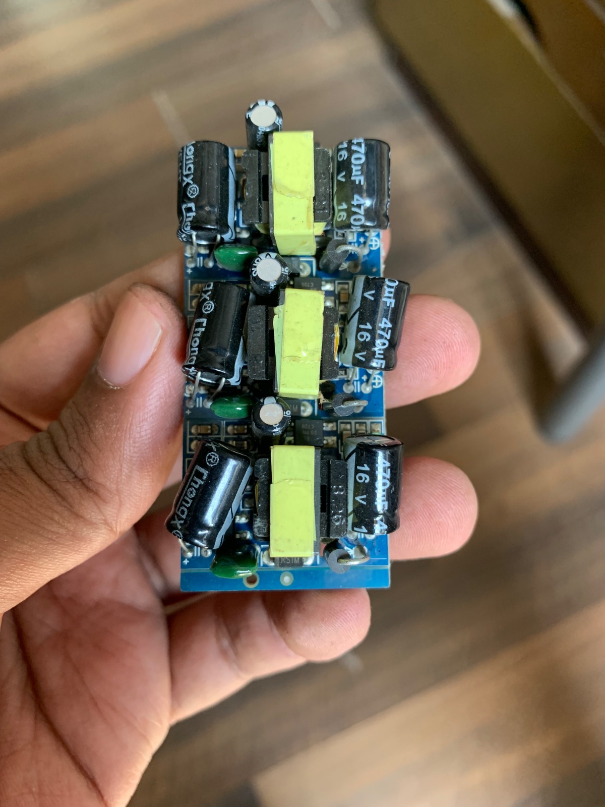

I have a couple of devices fail mostly the power supply devices never the complete module.
I would recommend using some safety fuses in-line if you are using PCB brick power supplies.

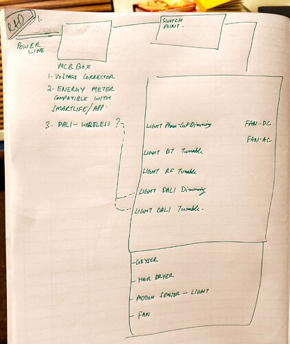

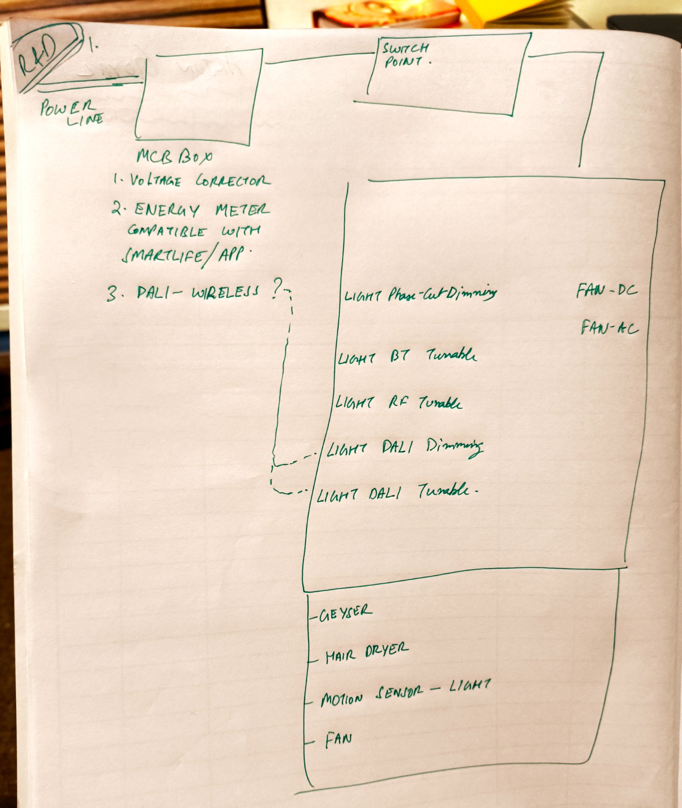

Can draw a simple layman drawing from Mcb box to switches, mentioning the equipment and connections? It will really help :slight_smile:

Layouts like this shall really help

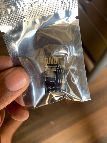

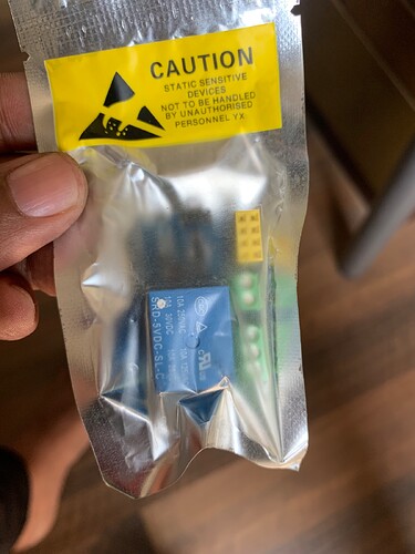

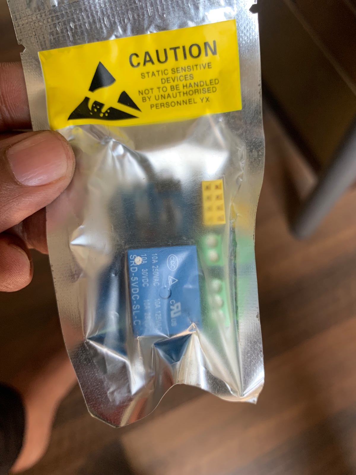

In case anyone is planning home automation and needs ESP8266 with Relay Board and 240v to 5V supply boards, let me know. I have ~50 sets of them lying around and can ship at a cheap price. Not sure about shipping costs though.
You need to make a Sale post in the Marketplace instead of hijacking this thread.
Sure, just that I do not have access to the marketplace yet. This was just to help OP and other TE members interested in home automation, and I do not intend to make any profit from this. But please let me know if this should be removed from here.
