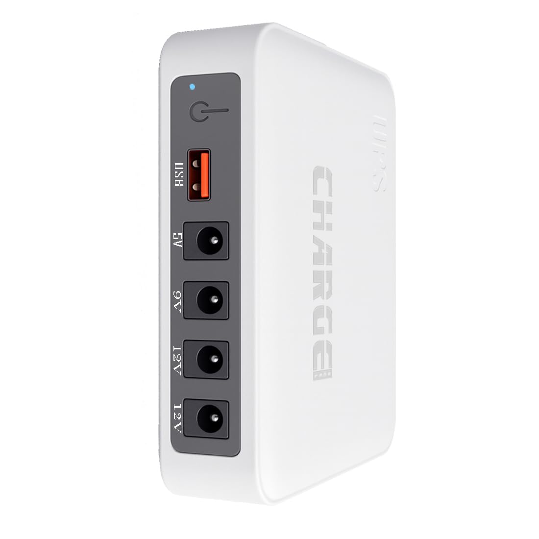

It’s a Slate 7. Runs at 5V, 9V and 12V. Want to use it with this router UPS

Careful, the router UPS you have gives out passive 12V.

The converter you are looking for will directly feed 12V into your router. This can damage things.
I guess the safest passive voltage your router can take is the 5V because it’s the standard and negotiations happens on 5V. But I am not sure.
This sounds like bad idea to me.
just use a type c charger, 5V3A 15W will do.
If you want battery backup, try the router UPS that comes with USB output.

I already have the UPS (was using with MX4200), so thought of reusing instead of buying a new one.

It is extremely easy to mess up the voltages.
As the barrel connector supplies a constant/single passive voltage, AND DOES NOT NEGOTIATE, you can easily ruin your previous and expensive piece of electronic equipment.
