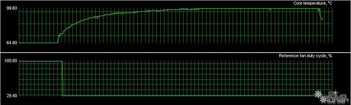

Idle temps are still 65C and while testing on load(playing a Prince Of Persia-2008), the gfx fan duty cycle suddenly reduces from 100% to 30%…and temps are 99C:
[attachment=10558:17497.attach]
What is the reason behind this?:huh:
I have set it to 100% using “System Tweaks” from RivaTuner - Driver Settings…
This change happens only while playing a game…and not while idling…???

BTW, the fan problem is solved I think when I kept low-level settings to 100%…and system settings to auto…with these, its staying at 100% through out the game and only starts reducing proportionally after closing the game…
