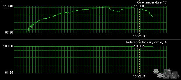

Initially I never monitored its temps…but recently when I started having a look on them…I found this:
Idle: 74 C
Load(playing Prince of Persia-2008): 107 C
So, I searched in this forum and found out about 8600gt heating problems.
Then, I tried fanspeed=100% from rivatuner but still almost the same temps.
Then finally it removed the hsf, cleaned it, applied CM thermal grease(leftover from CM Hyper TX3) on the core…
Now the temps are Idle: 68C and Load: 94C

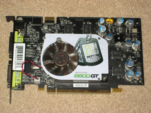

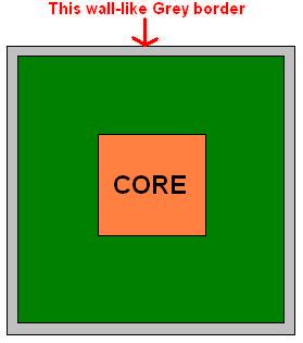

What I want to know is should the thermal grease be applied on the wall-like border of the core…?
What i mean is:
[attachment=10516:17445.attach]
If yes, then I will have to buy a new thermal grease…:slight_smile:
Thanks in advance!!!
Only on the orange section.

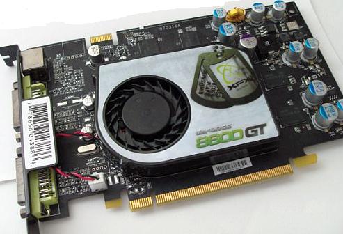

  1. Check the Fan on your HSF, it might have worn out , so must be spinning really slow making a lot of noise.
  2. Check the airflow in your cabinet a front intake and a rear exhaust fan is enough to keep your GFX’s temps ~ 55C idle(max.).
  3. Post a pic of your HSF here, XFX gave 2 type of HSF models
    a)
    b)
If it’s the first one, remove the metal plate and keep it removed.
If it’s the second one, there might be a problem with the fan(most probably) or airflow.
In both cases remove the HSF, clean the HSF and reapply TIM.
Local ceramic white-TIM should do the job for such a small GFX Card.

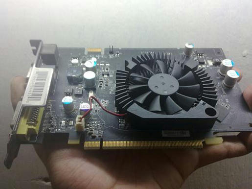

I have the first one but with a different type of fan:
[attachment=10524:17457.attach]

My 8600GT idles @ 50C and under load does not go beyond 71C. Now compare this to your result. There’s something wrong with your GFX card , check the capacitors and Voltage regulating ICs. Remove the brand plate"XFX 8600GT" from the HSF ,and check if the fan is rotating properly?

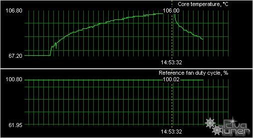

Fixed one more 80mm fan to the side panel inline with the card…outward blowing…no change… :no_entry:

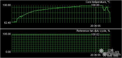

[attachment=10537:17475.attach]
Changed to inward blowing(intake)…still no change… :angry:
[attachment=10538:17476.attach]
Should I reapply thermal paste and try…or any other suggestions guys?

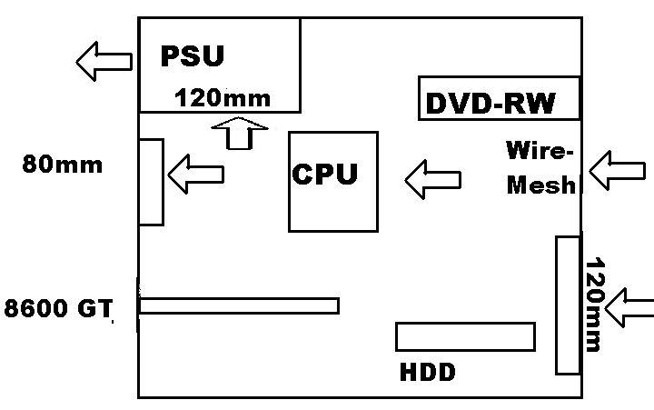

Make 120 mm Fan an Exhaust. It should be near the gfx card on the side panel.
This should help. worked for me, when I had 8600GT.

There is no spce for a 120mm fan ner the side/rear panels… only front panel can be used…
This is my current cabinet layout(with one grill above the CPU and one above the 8600GT on the side panel):
[attachment=10540:17478.attach]
