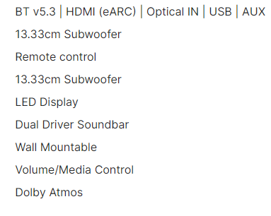

Below are the key features of both the soundbars with connectivity options( I don’t care about BT version):
**[JUKE BAR 1000](’
Zebronics Juke Bar 1000 - Soundbar
)** lkjsnfkwsnkfmnskm,vnskm,vs,mnvs,mnv,sjnlsnvlksnvlskvnslnvs **[JUKE BAR 9700](’
https://shop.zebronics.com/products/zeb-juke-bar-9700-pro-dolby-atmos
