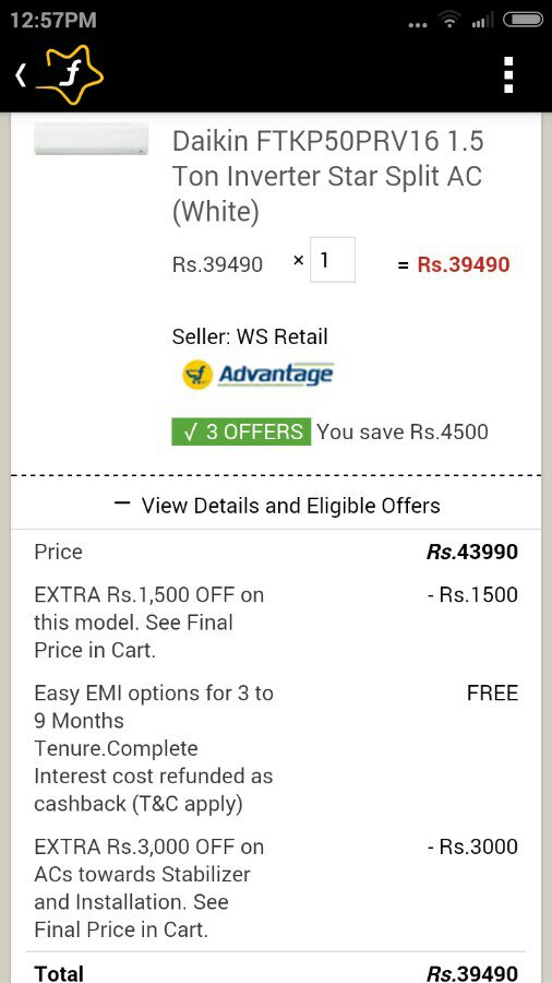

I kept it in cart for 3 days, Flipkart automatically reduced the price to make it more tempting...
Great marketing strategy

But definitely with costlier items in cart. It depends upon the selling pressure on their side and the unsold inventory they're having. I usually get a email on day one reminding me to buy the product in cart, later some discount ensues.
