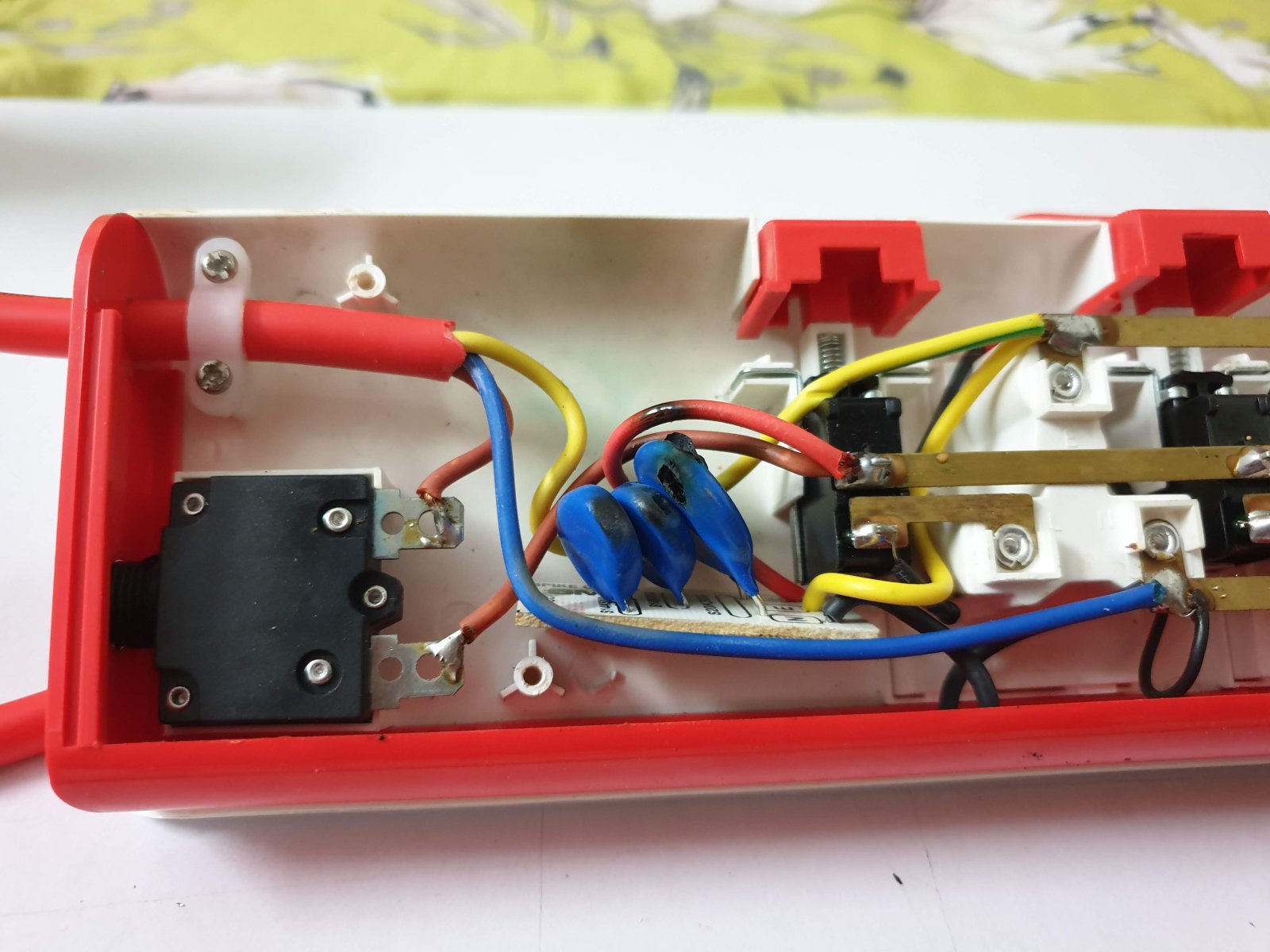

Here is the internal of the MX " Surge Protector " . It has 3 metal oxide varistors used in parallel which cost around 10 rupees each . A cap which costs around 50 and a blow fuse which costs around 10 rupees . Not worth the 3k plus .
Reactions: rsaeon

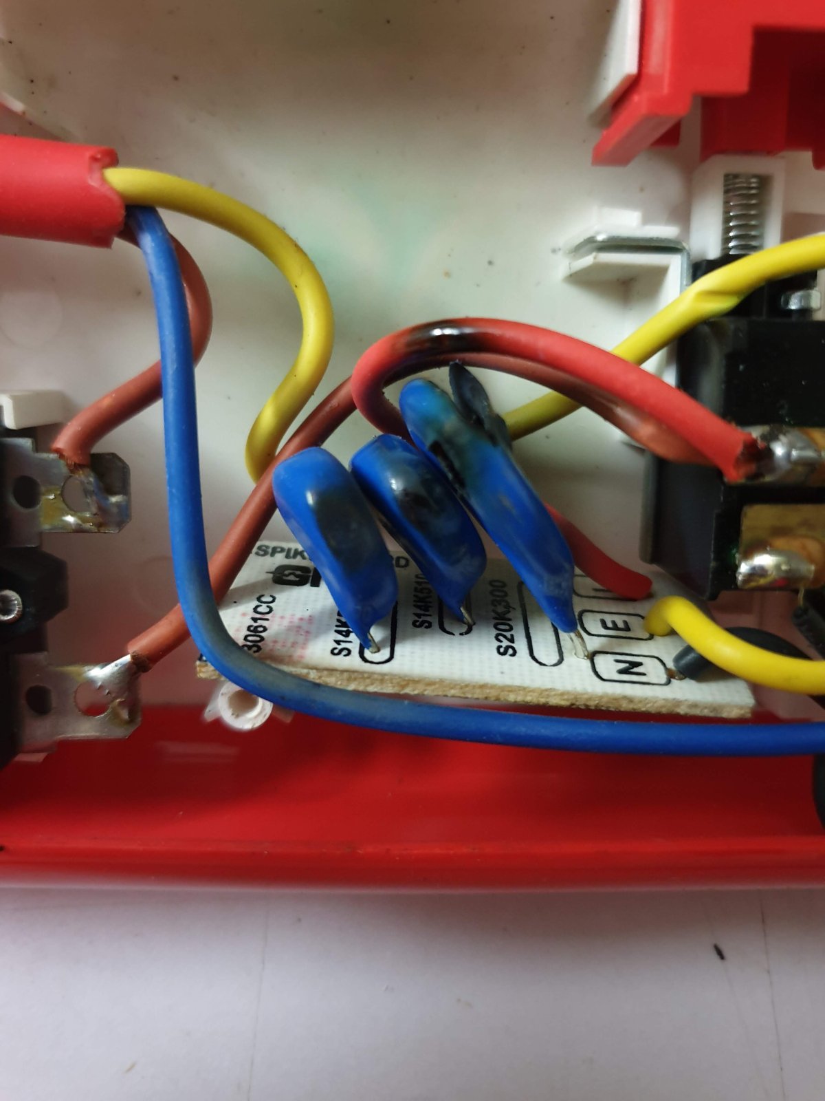

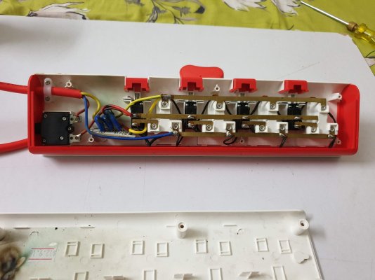

Another model called GM 3061
These things didn't last well, used to get burnt out/damaged within a year or so.
Has individual switches and mov.
These pics are old ones I have, I threw it away while I was shifting to a different city, but you can get an idea how they look inside.
  • Love
Reactions: rsaeon and Emperor

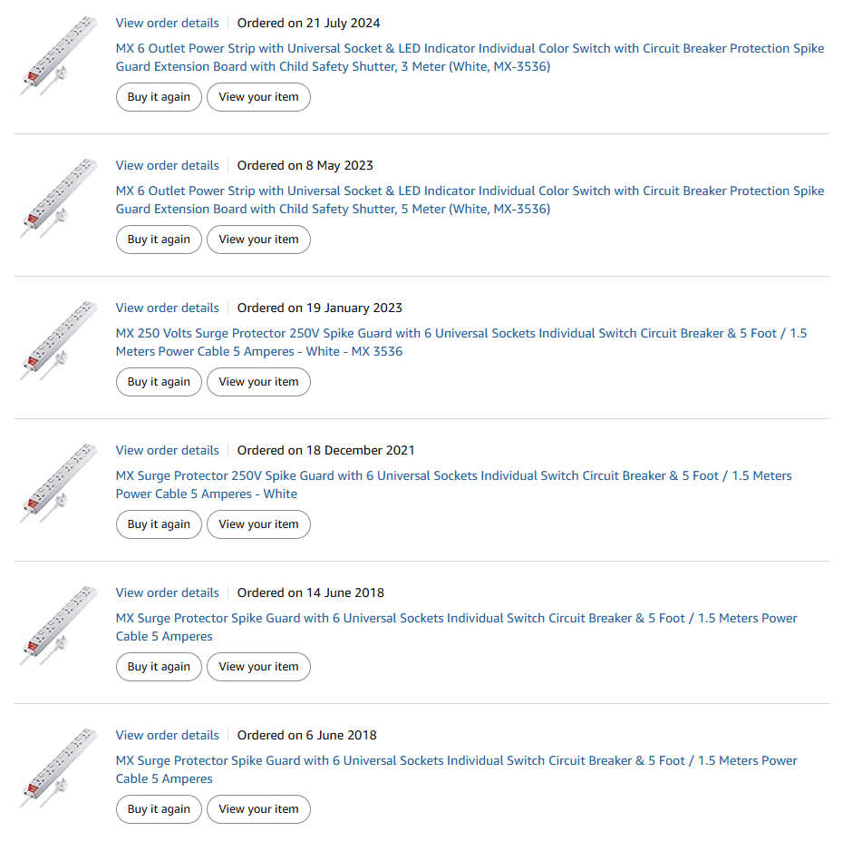

I have about 10 MX surge protectors with individual buttons. Some from Amazon listed below and some on FK and others depending on best price. All are the 6 socket ones.
Have been using these since 7-8yrs I guess. I love them cause they have saved my devices twice now. The have something inside that blocked the path of the Lightening surge that hit my house. I forgot what its called. I stupidly swtiched it on again and it conked off my Macbook charge, but it saved everything including my Routers and others stuff on it.
Someone on amazon or fk had opened it and posted whole pics of it. It was premium af. The buttons have lasted me 8yrs on off everyday except sundays. So you can guess.
These are absolute beasts and the oldest one only has one led indicator dead. Else all buttons working.
The price has almost doubled tho. Oldest one was 850. Now its 1349 - > https://amzn.in/d/evCaznI I've also got a few with 5mtr wire. So for smaller uses on inverter connected devices, I got cheaper discounted ones from good brands.
For any sort of serious work these are highly reccomended. Always get the 6 button one. Will get one more if I get card discount lol
