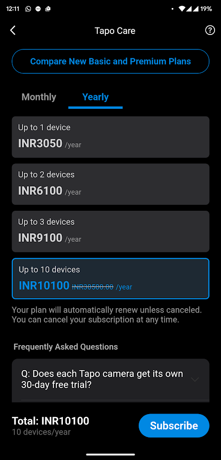

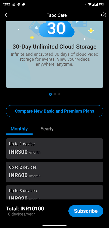

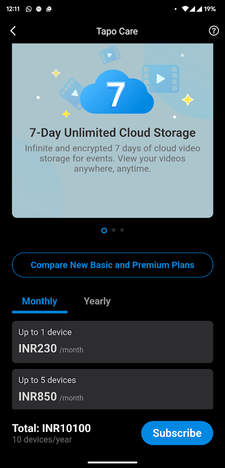

View attachment 197686 View attachment 197687 View attachment 197688
Let me know if you have any questions with TP link or CP-Plus cameras.
Thanks a lot for the insight. I am predisposed towards the Basic monthly plan for 1 device. Any ideas why there is a difference between the pricing of lockhrt999 & nando
iOS vs android pricing I guess
