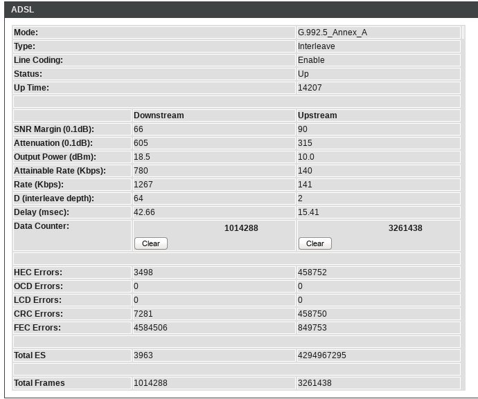

With BSNL i am getting only an SNR of 6.6 :(
I hope Airtel leads to better SNR.

Your downstream snr can be boosted yourself. but your upstream you have no control of.

The SNR is decent but your attentuation of 60dB is very high. you must be far from your exchange. which adsl modem are you using ? do you know what chipset it has.
As a test try to bypass the splitter and connect to the modem directly and see what values you get for attentuation ?
