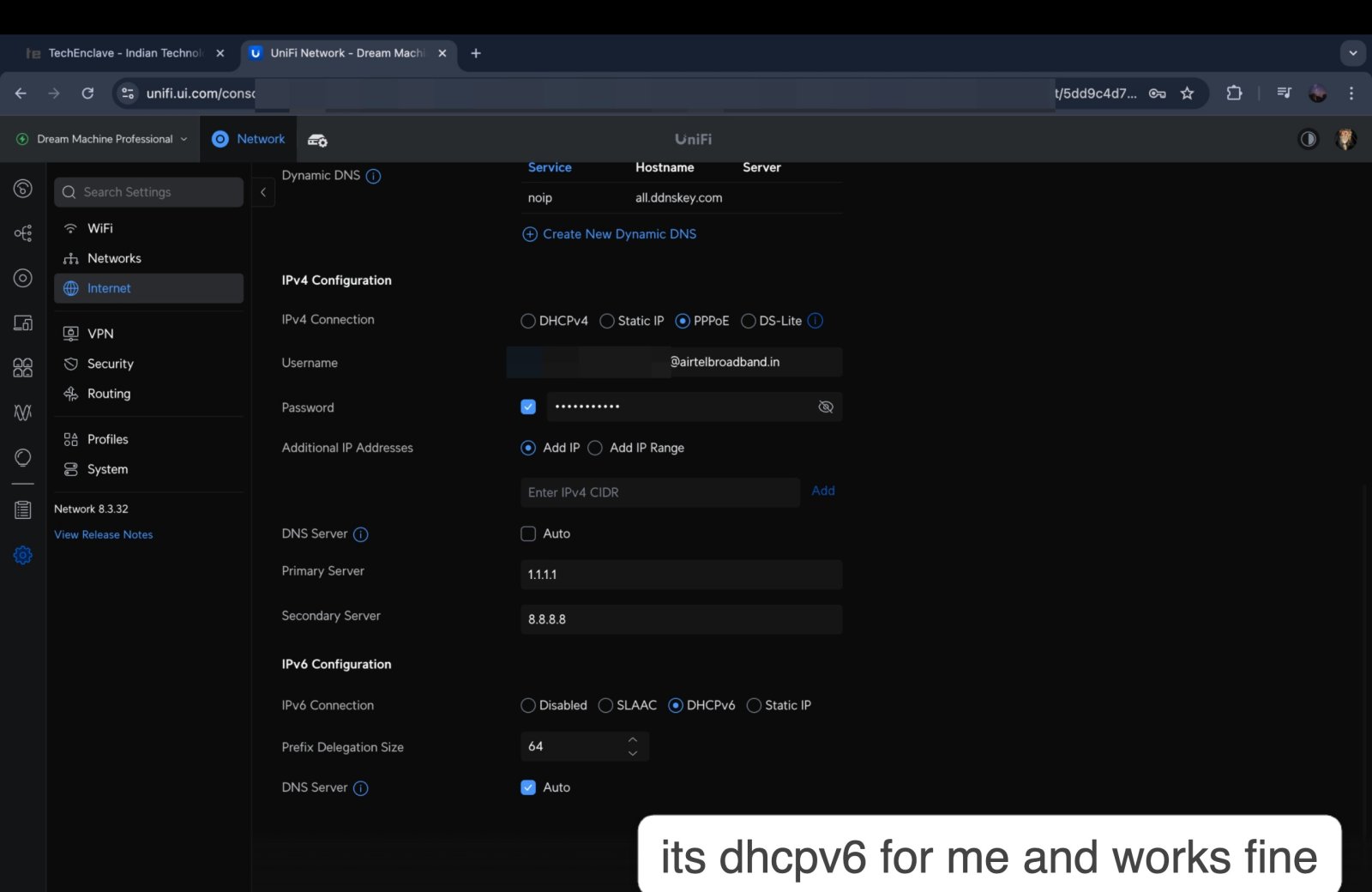

working perfectly fine here maybe try another dns server see if helps
unfortunately, on the Asus router no such DHCPv6 option to enable, I tried Cloudflare dns which is also the same
which router is this by the way ?
Native ipv6 is DHCPv6.
dream machine pro
