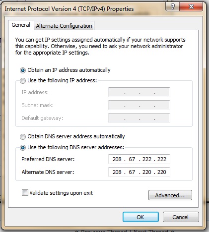

I am using this same modem for 512kb/s UL. At first there were some issues like yours. Since I'm using BSNL, their "Experts" came and blamed the Modem(Ironically supplied by them only). Replaced it, nothing got better finally told me that there are some noise in the line and got disappeared like anything. But with the help of one friends we rechecked everything and did port forwarding in the modem and DNS Setting like this: Now it ROCKS:hap2:

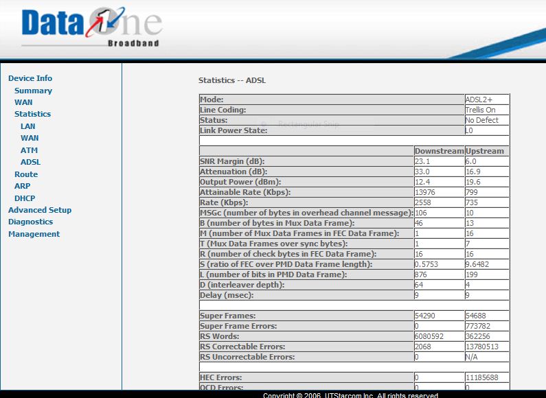

Just now Airtel guys from chennai called they told me its most probably my m0dem how could they say my modem is the culprit i am over 100Kms from chennai.We have lot of monkeys in the vicinity they bite all the wires be it telephone wire or the dreaded power cables they even electrocute themselves every now and then recently they stole a pack of motul 300V fully synthetic engine oil from my balcony it costs me R750 imported from france :@.The point is as you guys said its probably the line here is the screen shot of my modem please help:(:

Hi,
I checked your line stats. upstream SNR is not good. SNR margin should be above 10 on both sides to maintain a connection . if it goes below that, it should indicate line problem. tell your ISP to fully check your line.
Meanwhile, Please try and change Line Modulation from ADSL 2+ to G.DMT. G.DMT is quite tolerant to noise. the option should be somewhere in "Advanced Setup" .

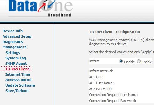

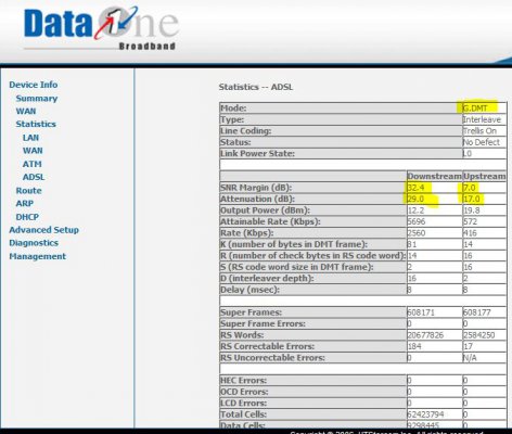

Thanks for the advice i googled what you said and finally managed to set it to G.DMT mode also i got this piece of info . that for this dataone modem i also have to disable tr-069 client when i use it with airtel .Now my SNR downstream and upstream are UP not by much though:clap:.Even the attenuation readings have changed attached screenshots below.Thanks man appreciate the help :D
Thanks dude i changed to that Open dns too :hap2:.
