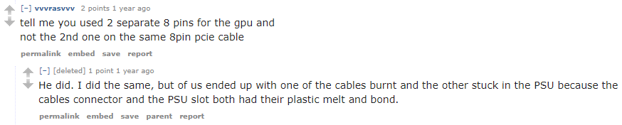

See this reddit thread:
Antec denying warranty on HCG 850W Gold burnt cable

They were correct to deny warranty. If you see the images, he's used only 1 PCI-e connector for 290W draw. You need to use 2 (from the PSU side, not one connector from the PSU and use both the 6+2 on that cable.)
A single PCIe 8pin cable and connector’s maximum current rating is 12.5A, which is 150W (+12V x 12.5A). So SilverStone’s warranty will not cover damages or malfunction resulting from the use of a graphics card or expansion card with a single PCIe 8pin connector that exceeds standard 225W total power draw (150W from PCIe 8pin connector + 75W from PCIe motherboard slot). Similarly, a graphics card or expansion card with dual PCIe 8pin connectors that exceed 375W total power draw (300W from two PCIe 8pin connectors + 75W from PCIe motherboard slot) will also not be covered under warranty.

I saw this reddit post after purchasing Antec sp1300, I rechecked my pcie cables and saw small shining solder joint at psu end connection of the pcie cable. Removed the cable, pushed the ground cable sticking out slightly and reseated it. Have been using for a year no issue with 1.1-1.2kW load for hours to days.
Would caution anyone purchasing to check all the cables to see they are in place and seated properly before plugging. Antec should improve their QC, apart from that these are seasonic units, very reliable.

This random 3rd party says, but I don't see anything from the OP saying so, and the images he's posted say differently. Even in the picture where all of the connections are still connected to the PSU, there's only 1 PCI-e power in use.
