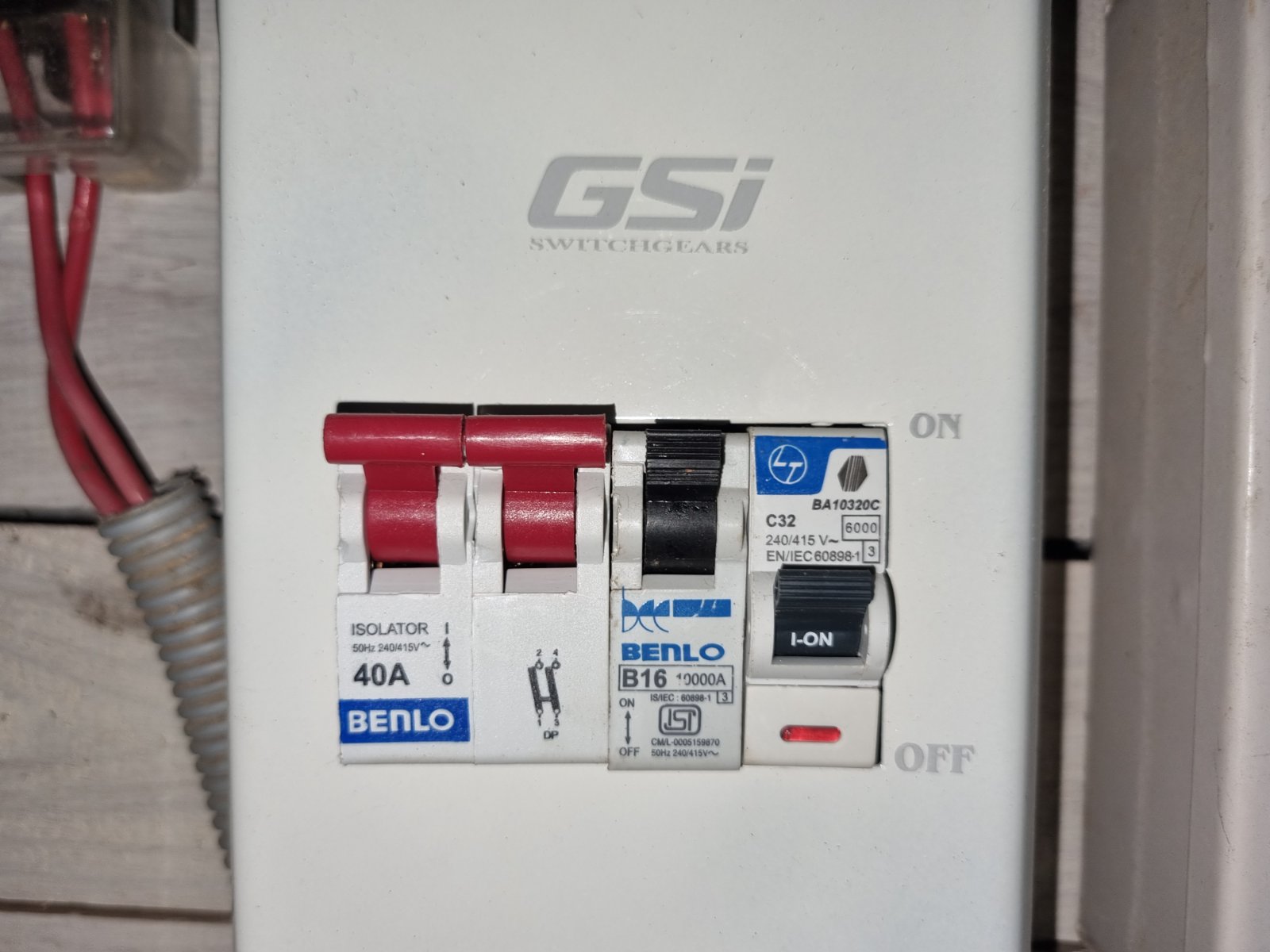

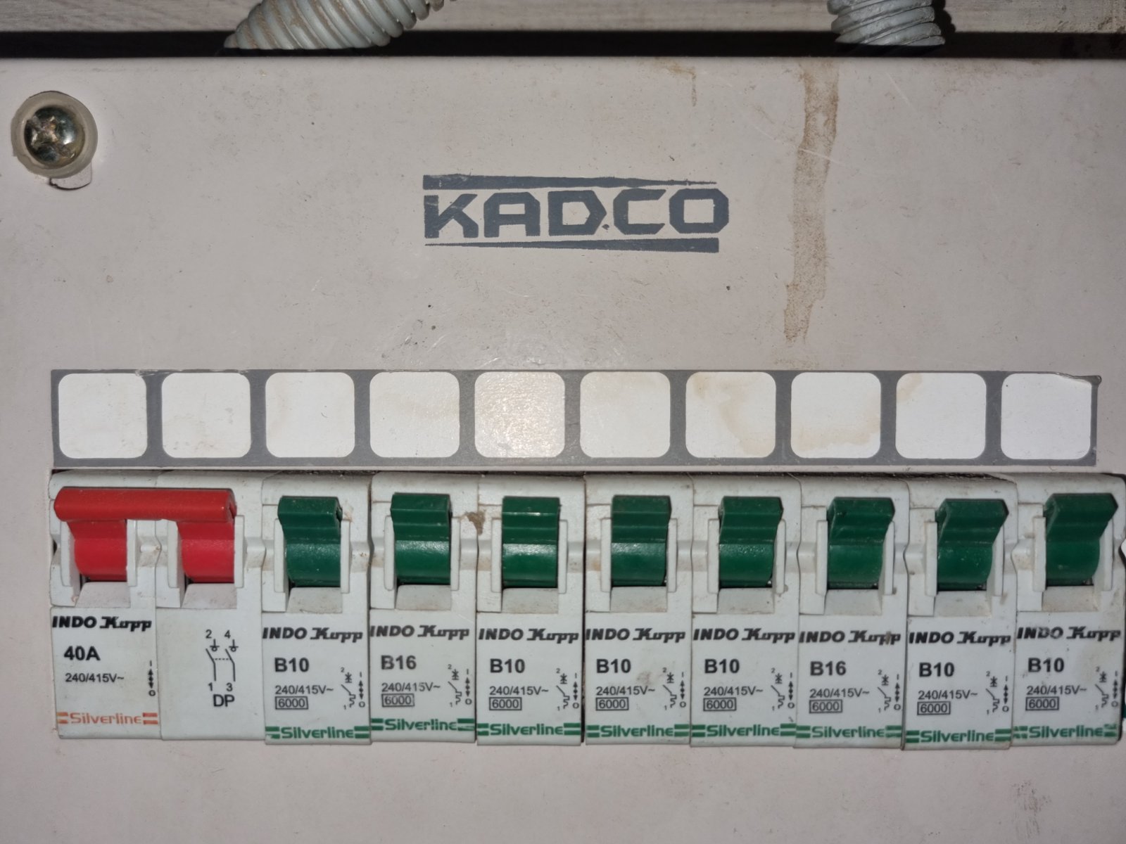

These are all the mcbs that are installed in the meter box. Do you see any rccb installed?

As per my observations I don't particularly see in the images share the RCCB, they are regular MCBs with varying current capacity.
I have had various experience across India, not all electrician set these devices.
In some places they have RCCB (mounted close to main mcb devices), as soon it detect leakage current, like an issue with geyser it would trip the whole house main MCB.

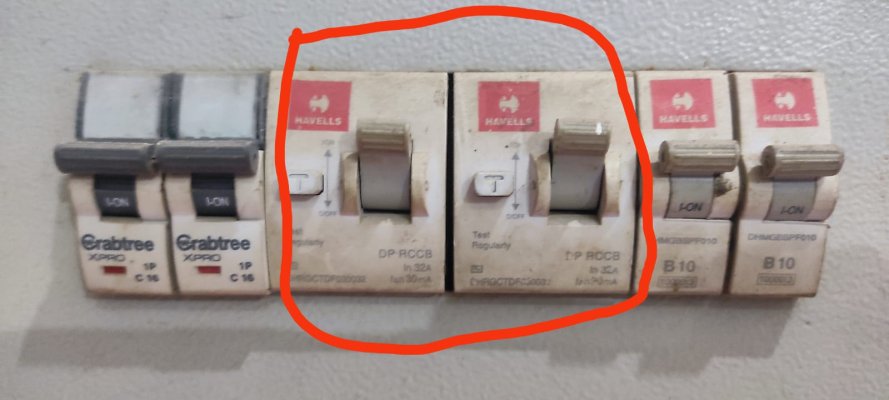

Here is Photo of RCCB. The 2 in middle @ encircled are RCCBs.
Can we install it now and can a normal electrician install these?
Yes, You can get RCCB installed now. Get the electrician who did your MCB installation. After Installing RCCB, test its function by pressing the small button, it should trip the MCCB. Also get your earthing checked whether its upto specs and functioning properly.
