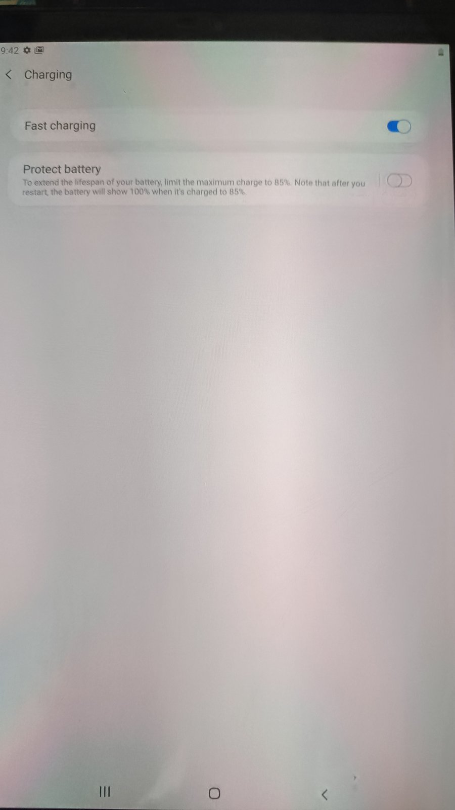

Yes . I already put it on battery saving option .
But in this S4 tablet...it allows to be charged till 85% instead of 80%.
I think that is also okay.
Edit- There is a fast charging option too . Which I have enabled it.
I have read a bit on Fast charging and it seems there is no proper evidence that if it harms the battery or not.
So for now I will continue using it.
This is an interesting and highly useful setting. Please show a screenshot of this setting.
Reactions: alap4m
This setting should be standard or available for all Android smartphones. Users will be able to significantly extend the life of the battery (and the device) by activating this setting.
Now that you mention it. It does seem a good option to have.
But How much it really extends battery life is very debatable.
So maybe that is why it is still not been giving as an option because see that 80%-85% limit to charge battery has become norm now because it seems to have been very confirmed that it does help battery life to extend .
