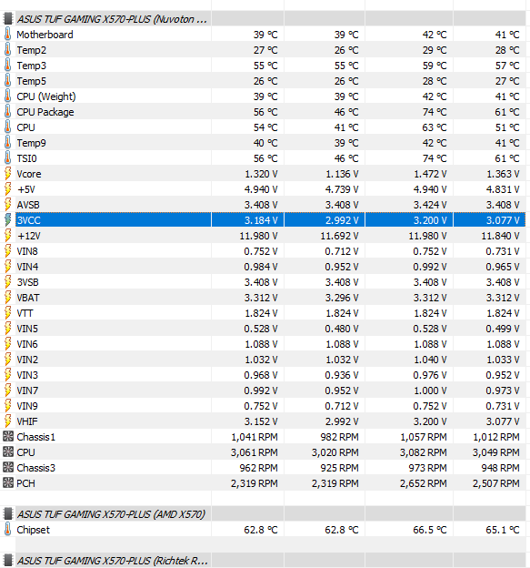

Check your 12, 5 and 3.3v rails using the Asus app or something like HWINFO. I had an issue where my 3.3 was dropping below 3 and causing the NVME to not get enough power leading to a BSOD. Do you have any cable extensions? How old is your PSU?

It is 10 years old PSU Corsair VX550. That might be the bad apple here. But I don't want to keep buying new parts randomly without being sure.
You are right I think , 3.3v rail drops to 2.92V.

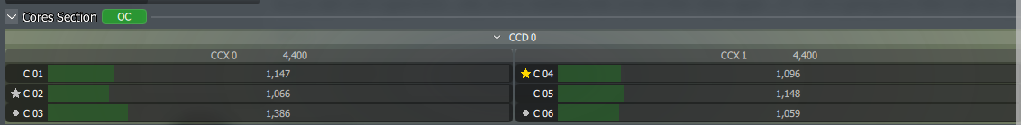

Update : I ran OCCT CPU test and core 5 is giving errors. I am attaching log also.

Attaching screenshot of new hwinfo after 1 hour of gaming. Same issue just like before in gaming and mouse cursor freezing randomly too in windows.
As you said core 5 gave error....why not try disabling that ccd and then check again.....if 1 core is giving error then it can be cpu issue.....ccd can be disabled from ryzen master afaik.
I disabled core 6 (core 5 its called in OCCT as it starts from Core 0.1.2.3.4.5). But you have to keep both CCX symmetrical so I had to disable Core 3 also or settings wont apply.
After doing this gaming was very smoother but jitters/stutters were still there but a little lesser.

Also BSOD issue is fixed when I changed to new PSU but stuttering problem is still there, you can check other thread :
