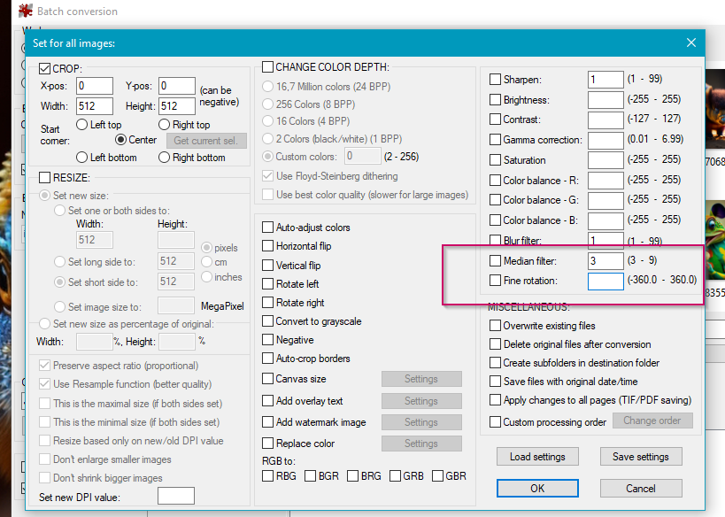

Irfanview also has Rotate Clockwise - R and Counterclockwise - L if one image
If you're doing a batch, I do not understand why you're flipping everything when you can just do a 90, 180 or 270 rotate in the fine rotation setting here?

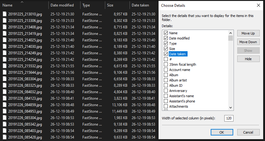

Why do you care about file modified date when both file name and EXIF have the date-time the photo was taken? Sorting by file name is also faster
I have lacs and lacs of digital photos so cant open every file to peek into exif. The basic windows modified date details works great for my scenario.
I referred to few tuts and photography forums and thats what they suggested.
I did tried the fine rotation thing but few pics got tilted to some 4-7 excess angles. So again the pain to manually recorrect base don angles which is an added pain further.
Anyways, now all pics are in proper orientation with no changes to any dates and exif which was my prime motive. But will keep exploring more such tools which provides hassle-free AIO things.
I didn't ask you to. exiftool and LightRoom can read that and if your phone is not naming the photos in YYYY MM DD_HH MM SS format, you can do that using the EXIF.
For pics from cameras/phones that don't use the above naming format, I read the Date Taken field and rename the file to that. This allows me to merge pics from multiple cameras and have them all displayed chronologically.
[DSLR pics renamed automagically to Date Taken]
And like I mentioned earlier, sorting by file name is way faster than on modified date/Date Taken. I also have lakhs of photos/videos archived and speaking from experience.

I dont mess/fiddle with phones naming conventions. I keep it all stock As is!
I maintain different folders across devices but in same events folder so it becomes easy for me/family members to figure out which/what pics/vids were taken from which devices. And this pattern has been since 2 decades now so cant make any changes to the entire library with any new organizing pattern.
Everybody has their own idea of maintaining data and this is mine.
