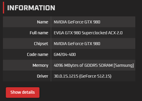

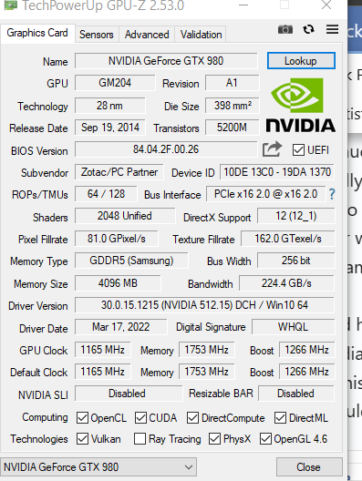

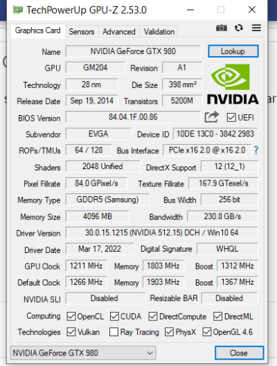

Recently I bought a Zotac 980 Amp! Gpu-Z and Occt shows its sub vendor is Evga is there any chance this card is fake or It might be something else?

can be a flash card. but why would you get a 980 in today's time?

If you are facing stability issues, You can look for your particular card's VBIOS on this site and try flashing it.
Yes, I have to downclock the card just to prevent it from crashing while gaming and it gets real hot like you can smell the card heating from at least a meter away while gaming. Initially I thought Occt is showing false information but it is also same in Gpu-Z.
I will have to look what I can do about the VBIOS, I have never flashed a card before.
What if it is a Evga card with Zotac fan and backplate? Will it break the card?
Thank you very much!
You singlehandedly fixed my issues flashed the card it works flawless now no crashes no burning smell nothing.

Given how customised the PCB and cooling designs are between vendors, it seems unlikely. Flashing a different VBIOS though is more common. The VBIOSes with higher clock/power limits are usually meant for cards with better power delivery, cooling and better-binned silicon.
Sometimes there are apparent problems like instability, artefacts, black screens, ports not working etc. And sometimes everything works but the card might degrade faster.
