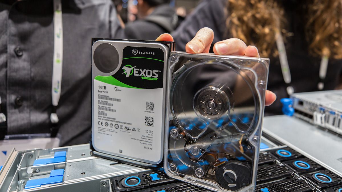

i work in storage industry. we deployed data centers bigger than backblaze.
on the NOPE part. i agree exos are not for consumer consumption. they are enterprise drives and their price includes validation etc… for enterprise use and regular consumer using them without warranty defeats that purpose.

What good is a 16TB exos with no warranty? It's a sports car with no seatbelts.
I need a 16tb drive for my home PC. why should i not choose an exos when there are no other options around lol? FYI retail exos costs like 50k and the shuckable one 22k or something. That is also a factor when discounting warranty no?
