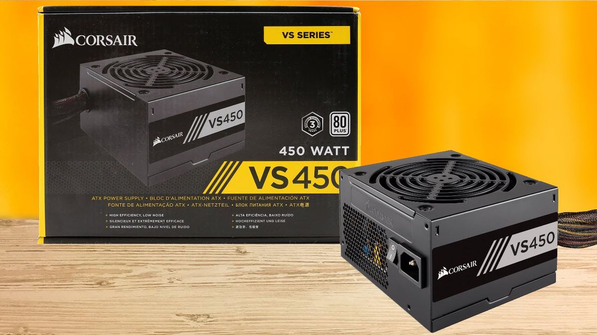

EDIT: My old PSU Corsair VS450 has a holdup time of 19.6ms and maybe the Gigabyte B700H 80+ Bronze is far less...
