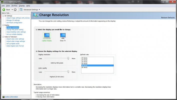

go to nvidia control panel and create a custom res. of 1366 x 768 at 60hz ur lappy should pe able to adjust with this res. and ur lcd's will definitely do with it....try this and report
tried changing the resolution, but could not find any option to change it. And strangely, the LCD does not recognize 1360 x 768 resolution, but works when set to 1600 x 900 but with truncation on all sides
