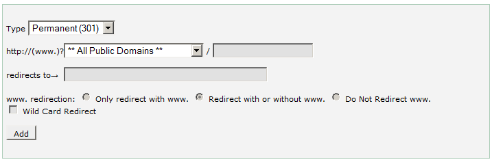

Regarding the permanent redirect can you tell me what should I add in the following redirect settings inside the cPanel -
I could not see that image behind the websense but you can follow this article to setup a 301 redirect - Redirects
As for your site related problems, I can only help if I set it up from scratch. Otherwise you can try it yourself. I am not really good at remote troubleshooting. :p
REY619 said:
Yes that is the correct path. The problem is I can not even log into the site, it just keeps on giving 404 or reloads to main messed up index page of the forum.
Thanks.
Use the following settings :
http://(www.)? <Your Addonsite.com> / <leave this space blank>
redirects.to---> <youroriginalsite.com/youraddonsite>
and check this option --> Redirect with or without www.
This will solve your 404 problem.
And regarding the messed up forum, you need to set the paths right as mentioned by Renegade already.
