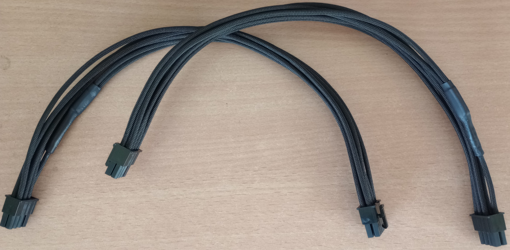

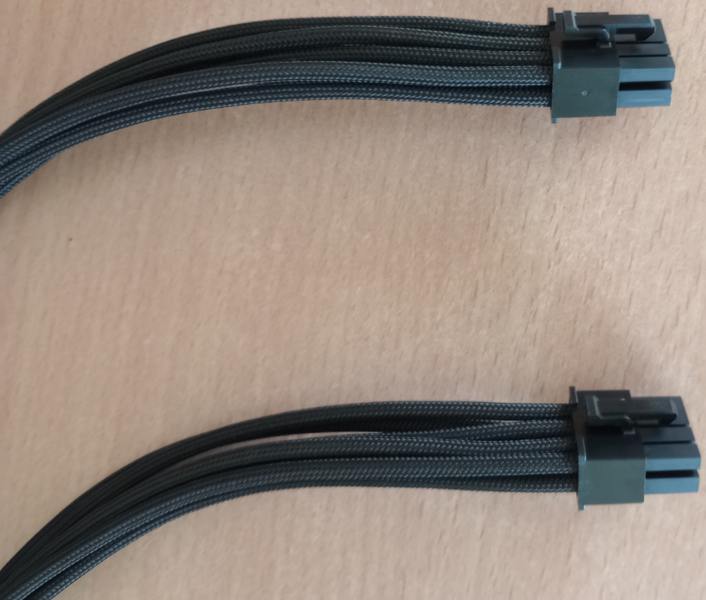

@immolationepoch The heatshrink is at the PSU end so it is easy to hide as such I use them in three layers(First to hold the sleeve, Second to hold the two wires from the gpu side, Third to hold the joint of the three wires) to make sure the joint stays put and provide enough stress relief for the cable. To be honest it can be reduced by about 1/3rd but I just wanted to make sure it is as safe as possible than going for looks. Thanks for the tip :grinning: and encouraging words
