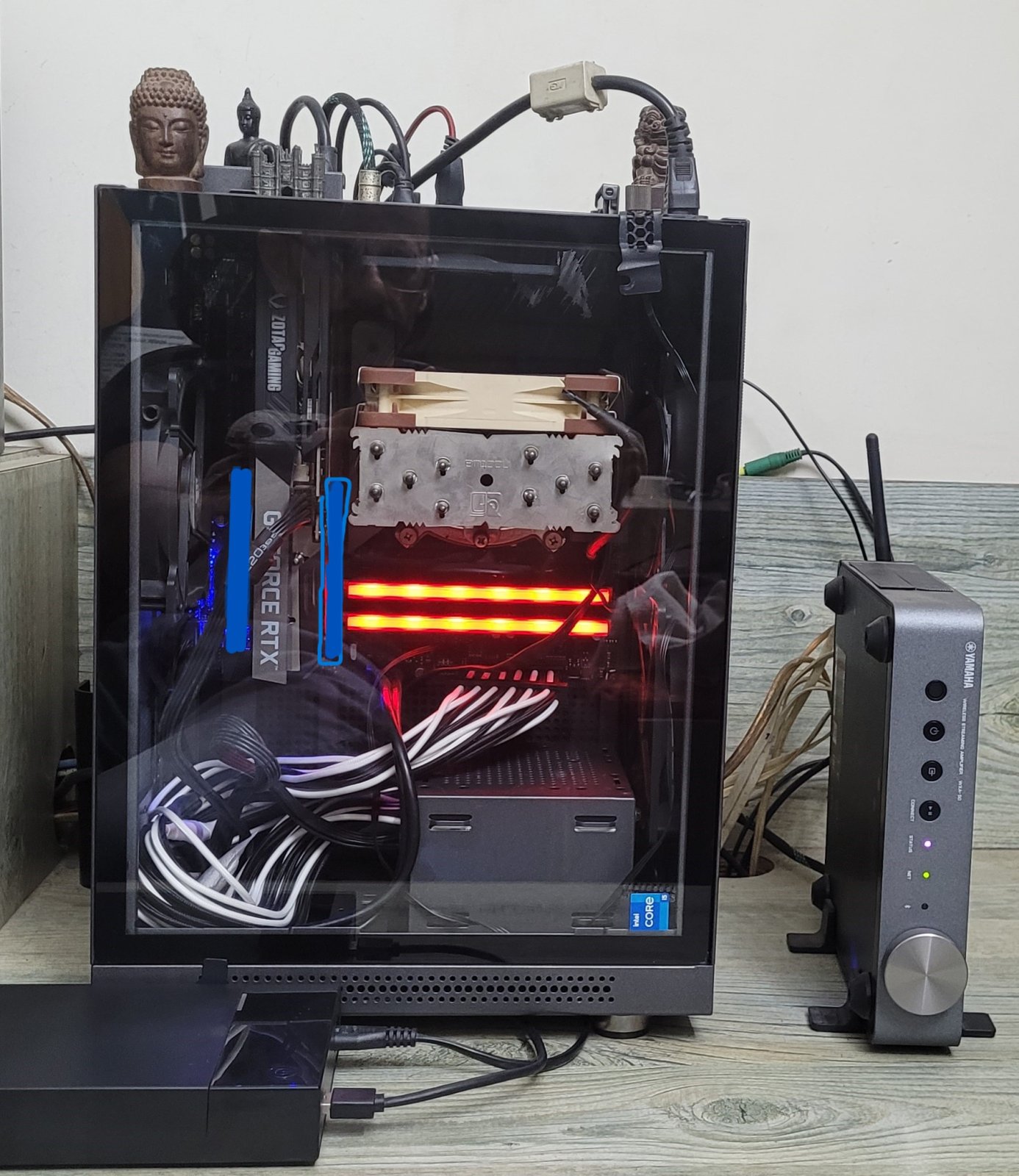

personally i prefer running all my components at as cool a temp as possible. Currently running two NVME drives, one with heatsink which came with mobo and one with after market basic heatsink.
the primary drive runs a bit hotter due to poor airflow around it but i still get idle temps of 42 odd eg
the second drive has better airflow so idles at 34 odd
without heat sink these were at 55-65 so totally worth it
primary drive on right secondary on left marked in blue

Is your noctua fan blowing air from or to the heatsink?

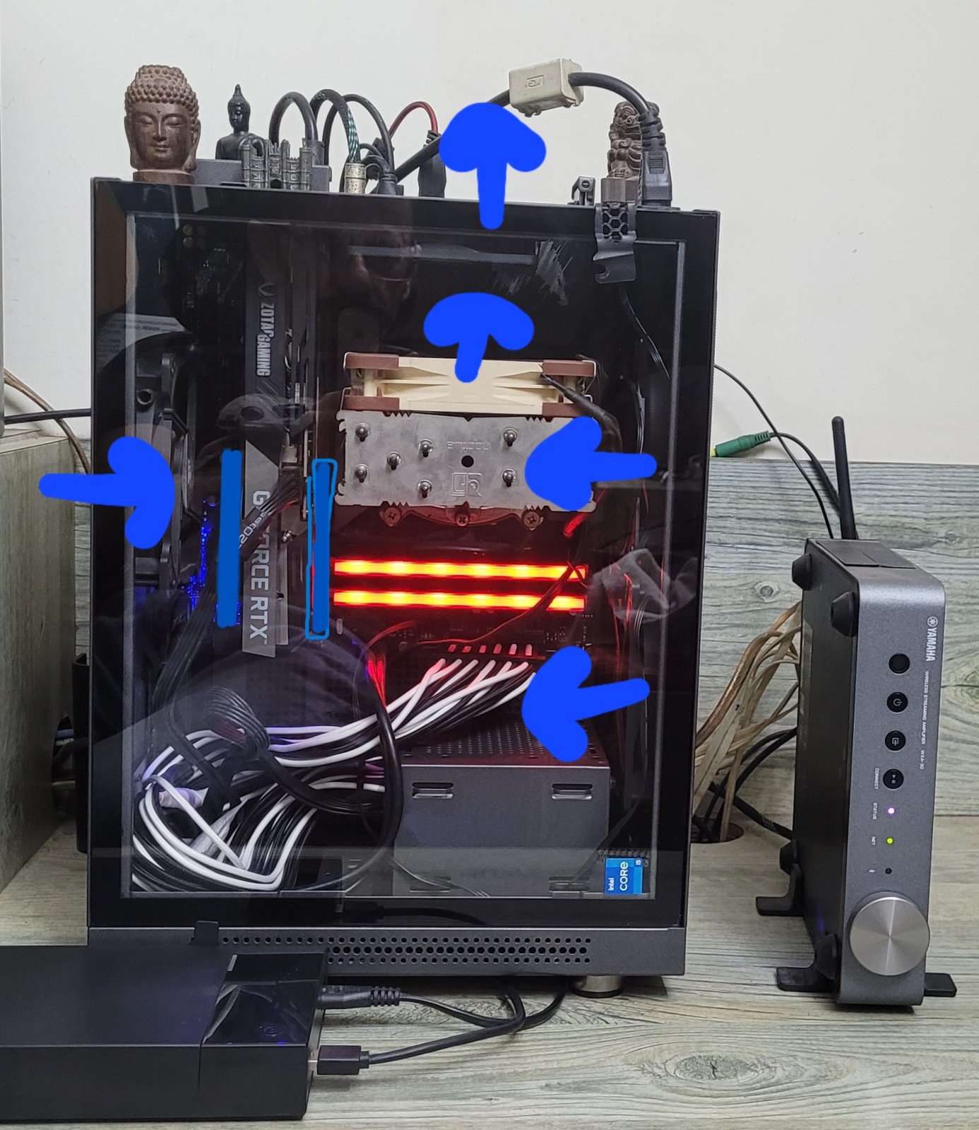

So i tried both options to see what provides cooler temps in this vertical case layout
Current 5 fan lay out is as attached in image below
Is the PSU fan on top? If it is, there's probably negative pressure around the RAM area (assuming your PSU fan draws air in). And looks like the exhaust side should be on the right, so is it pushing hot air against the bottom right fan?
If you could flip the PSU fan, so that it draws air in from bottom right, assisted by a fan there, and pushes out air into the RAM area, it should theoretically result better. Possibly not much, but just checking.

Thanks for the suggestions! Can't wait to take apart the easiest build in the world and put it back again :')
I am guessing by the looks of the cabinet and airflow that you must have tried many combinations for airflow before finalizing this one.
you are a 100% right, airflow experimentation is my fav demon to play with :)
have tried all and more options and permutations, this is the end result for now :)
(PSU fan is bottom pulling cold air from below)
The only last compromise i have settled for is Primary NVME sandwiched between GPU and CPU heat sink (but 40-42 idles is ok for now) thot about a tiny fan to blow air along it, but given up on that for now :)
