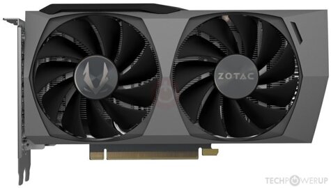

Hi,
Just throwing it out there...I was waiting for almost a year to flash an OC vBIOS to my Non-OC LHR 3060Ti just to get the Fanstop (Why they didn't do it in the first place is beyond me). All the OC vBIOSs from Techpowerup somehow were incompatible and caused artifacts and/or errors.
Note: As a side effect you convert your card to OC version :D
Only one unverified BIOS works without any issues, thanks to a techpowerup FM for finding it out (have been using it for a month with heavy gaming and professional use)
Original vBIOS:
New vBIOS:
You can't just flash any vBIOS willy-nilly. You got lucky that the card didn't brick.
vBIOS are designed as per board design of the card.
Always make sure when you're flashing the vendor and device id must match the original vBIOS.
Oh, I knew the risks and had already gotten artifacts, and device errors thrice. Also, have chip programmers just in case. Either way, the point is, that no one else has to go through the trouble again :)
Your card doesn't get detected in device manager anymore. You need to remove the BIOS chip and flash it through a BIOS programming device.
Absolutely correct.
