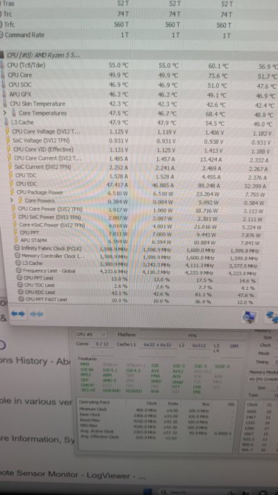

Btw I am not so savvy to understand the numbers.
Can you help me to check if it is within limits.
Here is screenshot of HWinfo64.
Let me know if any more info required .

The numbers look very good. In fact, it seems too low. Was HWiNFO running in the background the whole time you were playing?
Next time you play, try the following approach:
1. Run HWiNFO and open the sensors status window like before. Keep it running in the background.
2. Start your game and as soon as the gameplay begins, alt-tab and go back to the sensor status window.
3. In the bottom right portion of the window you will see a small timer showing how long the sensor data is being recorded. There is a clock icon next to it. Click on that to reset the timer and all min, max, and readings.
4. Alt-tab back into your game window and continue playing (15 mins or more should be fine).
5. Exit the game and now see your avg and max temps for CPU (Package temps, Individual cores), GPU, and GPU Hotspot. You can take a screenshot and share it here too.

@StygianClaw
Screenshot of the results.
Did exactly what you said.
Reaching 94°C and so..
Please note I am playing on external monitor through GPU( hdmi) with laptop connected to power outlet.

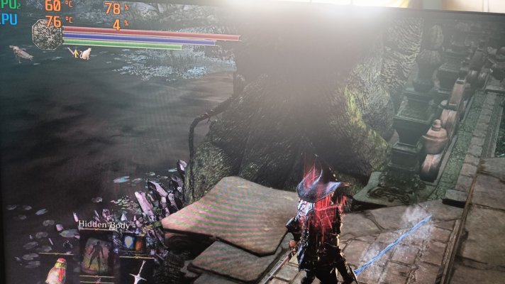

Edit:
Just after posting this ...started playing a bit more.
And now the temperature is well within 75°C-80°C...almost all the time.
I don't know want exactly happen now. Maybe some background app or program thing is causing this issue.
Attach second pic too
Average temps are still fine though at around 81c-84c
So I am guessing thermal paste is due.

I am planning to cancel my gledid paste order.
I have suddenly seen temperature very normal now.
I think it maybe due to some background app running or something I am missing.
But I have been continuously playing and temperature very normal it seems now.
79-85°C.
