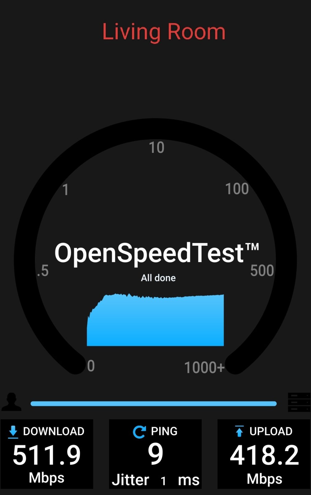

  • Wired Backhaul must be working. Here is how I know:
    • I plugged the router in one end and satellite in other end of the house. Did not connect any ethernet cable into the satellite. Bandwidth was ~30mb/s on fast.com, the main unit (router)'s status page showed 22% signal strength. The Satellite itself had blue light in the logo (indicating OK connection, not great).
      Screenshot taken on Nord 2, near Main Router.
    • When I plugged ethernet cable into LAN port of Satellite, logo went to green. Local speedtest ~550mb/s and ping ~9ms. (Ping similar to other WiFi I already had) Note that the main router needs to be in AP mode and both router and satellite must be plugged into switch with their LAN ports.

Here are my findings
  • View attachment 211924View attachment 211923

Didn't understand what you meant by LAN and then WiFi. These don't have LAN ports since I am using the only LAN port it had
In screenshots I attached, 4 and 5 are there. Bedroom 2 is next room, Living room is the farthest one.
I have 240mb/s internet, and all speed tests were local only (Openspeedtest running on my NAS).
Speedtest results on local host are almost as same as I got on Asus AC-68U (with respect to ping and bandwidth both).
fast.com speed tests maxed out the 240mb/s conenction near every satellite/router.
So You have a 240Mbps connection and are getting same speeds but Pics were showing 704 Mbps and 511 Mbps
I meant connect laptop with LAN port of router do a speedtest( through a switch if required ) , same place connect with WIFI do a speed test
Go to farther most room check with Router ( Satellite off)
Switch on Satellite and do a speed test same location . Now because satellite connection will be better device will pick that up on wireless
What this will achieve is Same place loss in network over WIFI using Router
Farther most place , speeds using only router then satellite , loss due to satellite
Because those speed tests are with openspeedtest server running on my NAS.
There's only one LAN port, and that connects to my main switch. Can't connect another device to LAN. So LAN test between two devices on the Moto router isn't possible with config I have.
Using a switch, connecting Moto device and another client to the switch, well it won't go through the Moto Router when it is in AP mode.
Signal strength was 15-20% as seen on Moto dashboard. Speeds were 10mb/s. Don't have a screenshot, but have tested this, and that's why I know that wired backhaul was working.
