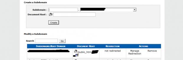

Is this where you made the changes?

No, I didn't add through sub-domain. I did it through permanent redirection through my cPanel. I will PM you my website address.
Do it through here, and remove the redirection.
- - - Updated - - -
Also, if you can host more than 1 domain on your server, then do a drupal multi-site setup.
You can use it for any sub-domains you create as well.
