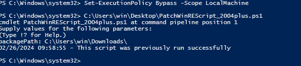

But not sure as to which policies to be allowed on local PC neither commands, took some help from internet but script seems running since last 30 minutes. (check attachment)
Attached script file as well in .txt
1. Can someone how to run proper commands and from where (CMD or powershellscript GUI)
2. Also the commands need to enable policies and disable them when work is done.
3 .Best way to run the script.

First run this to check current settings Get-ExecutionPolicy -List
Set-ExecutionPolicy Restricted - default execution policy for Windows client computers
Code:
C:\Windows\System32>powershell.exe Get-ExecutionPolicy -List
        Scope ExecutionPolicy
MachinePolicy       Undefined
   UserPolicy       Undefined
      Process       Undefined
  CurrentUser    RemoteSigned
 LocalMachine    Unrestricted
Code:
      Process       Undefined
IF you can guide with right commands to set right policy, will be useful
Code:
      Process       Undefined
Run this command
Run this command
Code:
C:\Windows\system32>powershell.exe Set-ExecutionPolicy Restricted
Set-ExecutionPolicy : Windows PowerShell updated your execution policy successfully, but the setting is overridden by
a policy defined at a more specific scope.  Due to the override, your shell will retain its current effective
execution policy of RemoteSigned. Type "Get-ExecutionPolicy -List" to view your execution policy settings. For more
information please see "Get-Help Set-ExecutionPolicy".
At line:1 char:1
+ Set-ExecutionPolicy Restricted
    + CategoryInfo          : PermissionDenied: (:) [Set-ExecutionPolicy], SecurityException
    + FullyQualifiedErrorId : ExecutionPolicyOverride,Microsoft.PowerShell.Commands.SetExecutionPolicyCommand
I am running CMD as admistrator
