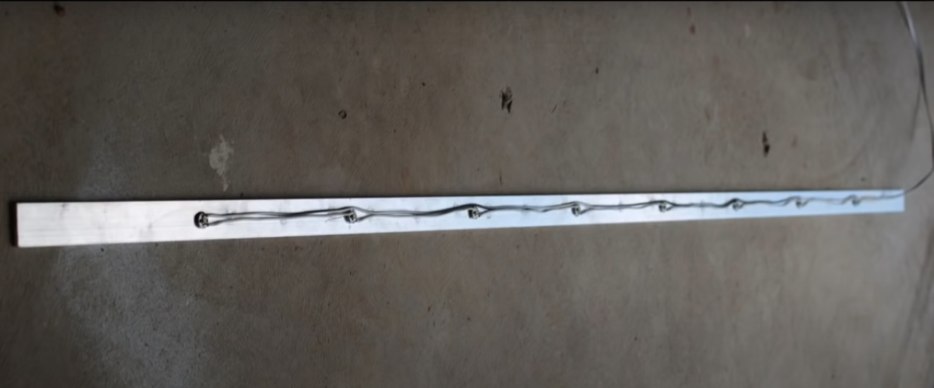

DIY - buy CREE high CRI leds from mouser, slap them on to a aluminum bar for heatsink, power it with a constant current driver. Face it up towards the ceiling to avoid glare. No idea how it will turn out, probably will need a lot of leds.

That's too diy, even for me. I have a bunch of Samsung LH351D 90+ CRI LEDs that I ordered way back from element14, and some CC driver that supports pwm dimming, but not gonna mess around with them for home lighting.
