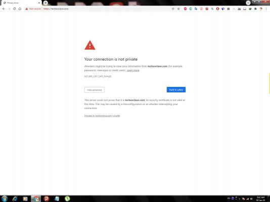

Hi All,Friends whenever I try to visit some popular websites using chrome browser It gives an error that "Your connection is not private" and there is a link to browse unsafe, I want to know

I have attached the picture of the current status of this website, I marked the red crossed address bar with the green color. Thanks

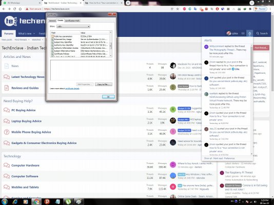

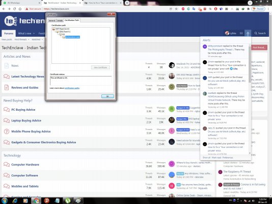

It's probably the older cert still messing around. Just to confirm, can you post the certificate info of the website, something like this(click on the padlock icon in the address bar-> view certificate->certificate path)
Ok I will tell you tomorrow right now I am on my mobile phone and have no access to my PC as it is off.
@j3rwin

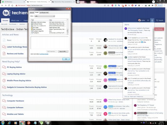

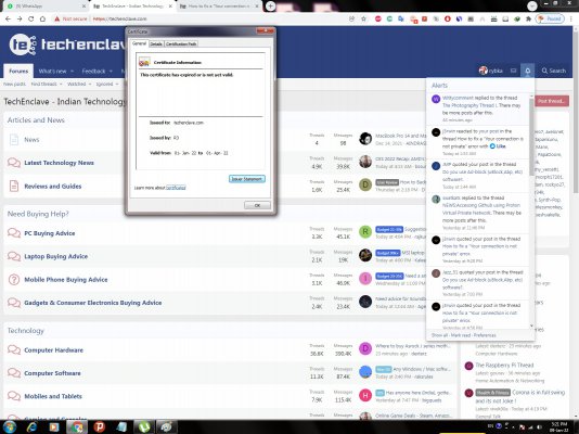

In the site Certificate's first General tab it gives error that certificate has expired or is not yet valid.
In the second tab i.e. details-show: all there is a yellow sign in key usage and basic constraints.
In the third tab i.e. certification it says Ok.
See in the attached link, thanks in advance.

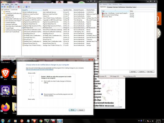

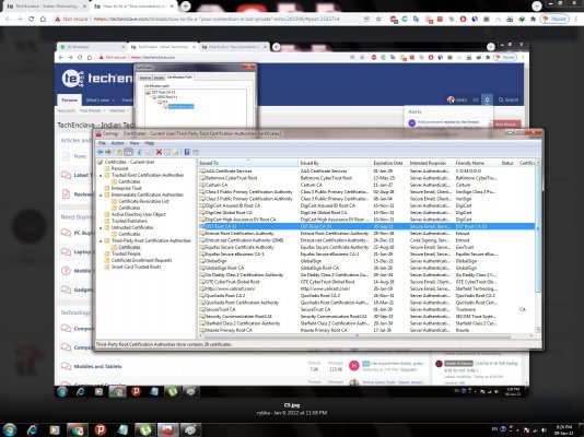

Ah, got it now. The DST Root CA X3(the one which expired) is messing with the system(the last screenshot). Just remove that cert from windows cert manager, it should work fine.

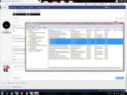

By using the command certmgr.msc in the run field and hitting enter key.
I found the list of all the certificates installed date and year wise.
I found DST Root CA X3 in two tab windows i.e. Trusted root certification authorities and also in Third Party certification authorities under certification tab.
Do I need to delete both of them? And also do I need to delete all the expired certificates installed in the OS? thanks.

Yeah
Not really necessary. If you face some particular issue then delete that.
I missed this part. Remove these as well, just keep the self signed certs.
Under Intermediate certification Authorities window I found the certificates issued by two authorities with the same name.How to identify the cross-signed one? I deleted the DST Root CA X3 certificate from both the tab windows.
Check the issued by column or check the details tab. If the issuer is DST Root CA X3, nuke it.

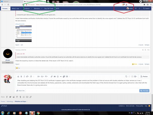

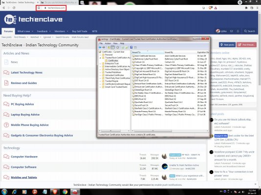

After disabling and deleting the DST Root CA X3 certificate it appears again in the certificate manager window and the problem of site not secure with double underline on https: remains as it was. I uninstalled the chrome browser and deleted all the history, passwords, cache, cookies, extensions run ccleaner software and downloaded the fresh copy of the chrome browser but it is again giving same error. I also tried with the Brave browser there also it is giving same error.

That's really odd. Just to confirm, you can see the X1 cert in Trusted/Third party Root Certification Authorises right?
It appeares again and again after disabling and deleting it, in the trusted certificates window.
This is the current state of the certification window.
See:
See:
I was talking about the ISRG X1 cert not the DSA CA X3.
I don't see it(ISRG X1) in the Trusted Root screenshot you just shared. Is it present in the Third Party Root Certificate? If it's not, add it manually to one of these places (by right click -> import i guess)
Now it is fine, I was simply left clicking from the mouse from the downloads so it went into the intermediate certification authorities, Now I went into the trusted certification authorities windows and by right click of the mouse after selecting import option I imported it from the downloads & now its all Ok, thanks alot. See the double signed cross error went off.
