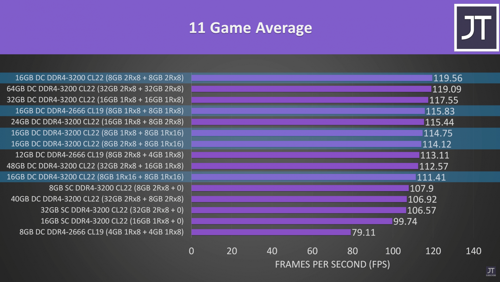

Get the same capacity 2nd stick for full dual-channel advantage.
Crucial, Kingston & Adata are popular & good. Get whichever is cheaper among them.
x8 RAM is better but rank also matters, 2R is better than 1R. Check the pic attached below.
Say you were hitting RAM bottleneck now with 8GB RAM & the CPU was drawing 25W in a game. After dual channel upgrade, the RAM bottleneck is removed & now you get higher fps but CPU power draw is 30W now. So yes, this will result in more heat generation. The heat generation happens simply because you are using more of the available performance with dual-channel memory.

Partially. You'll get dual channel experience with half of the capacity of 16GB stick (=8GB) and the rest of the 8GB will work as single channel. It's not that much of an impact, trust me. With laptops you should always prefer more RAM over dual channel config if you think you need it. Better not regret later.
